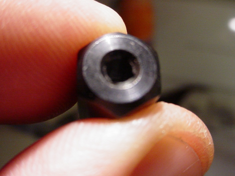

My dad recently gave me his Dremel-tool kit. Tonight at first use.... I found that I needed to use the wrench to remove the collet (which didn't have a tool installed).. I've had other non-Dremel rotary tool collets get stuck.. but usually there's a tool installed and I just press the tool's tip against a block of wood.. and the collet will loosen and the tool will slip out. I can't install a tool.. because the collet is too tight.
Any ideas?

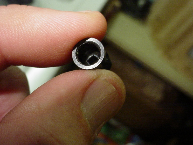

I was wondering if the collet is removable.. and possibly got installed backwards?

Is that a square hole?  If so, that's for an adapter for the flex shaft attachment and not a collet.

...so you're saying if you remove collet the inside part stays stuck up inside the outer collar, if so grab a small bolt that you can tap it back out with a slight whack?
Or lock the collar, get'er warm and pull with gloves. I've had them stick as well but they always freed up.
Travis might be on to something, i don't see any threads on inside collet.

WingingIt74 wrote:I think this is what you have.
http://www.mytoolstore.com.au/products/Driver-Cap-Hex-Nut.html
Thanks Travis (and Mark).. you're exactly right.. what I am missing is a collet nut.. and also the collet that accepts a 1/8" shank tool.
I found this collet in a bag with the keyless-chuck.. but it's too small for the tool I want to use.
Dremel tool collet stuck Dsc02313
I guess I'm going to have to buy the 1/8" collet and collet-nut.. because I plan to use the router attachment which warns against using the keyless.

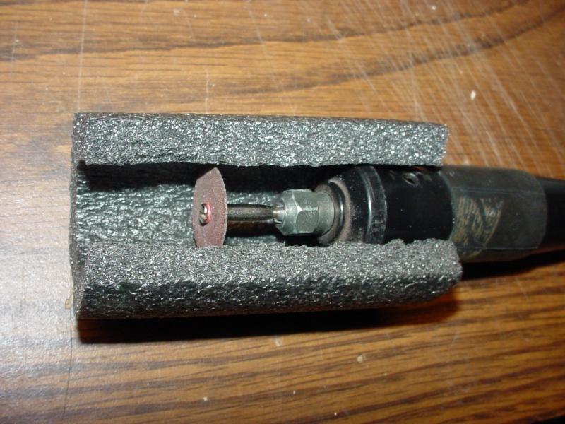

This is a Black & Decker "Hobby Shop".. which I've had for almost 30 years. It's cumbersome.. but gets the job done. The integral tool-carousel is handy.. but the large diameter of the hand-piece on the flex-cable is such that; using a cut-off wheel (as I most frequently do..) limits the distance for a "square cut".. to the length of the tool's shank.. especially when the cut-off wheel diameter gets smaller.
Dremel tool collet stuck Dsc02315
The piece of pipe insulation is something I devised to protect a cut-off wheel between uses. If you're making multiple cuts and need to set the tool down.. it serves as a protective cradle. How many times have you had a fragile cut-off wheel break.. by something simply bumping into it on the bench?
