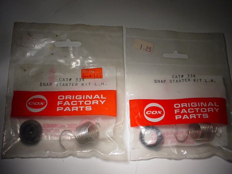

Embarassed well.. that would certainly make sense! Speaking of drive-plates.. I was looking at my cam-style starter-springs.. and most that I have seen are designed to fit the hex drive-plate. I bought a couple of L/H starter springs last year from a hobby shop that was going out of business.. and just noticed that one is solid.. without the hex molded-in, so it can be used on a round drive-plate.
It's the same Cox (#334) part though. Huh...
Posts : 5926

Roddie, I believe the one with universal plastic spring drive plate is the earlier one. This type came with my R/C Bee engine I purchased in the late 1970's / early 1980's time frame. Earlier engines I bought only a few years before had the frictionless snap spring starter. Later engines came with the hex shaped prop drive plate, which the cam'd version fits onto. The Corsair donor engine has this style but in the left hand.
Why Cox retained the same part numbers, I don't know. Perhaps it is just one of the signs that expertise at Leisure Dynamics moved on and left those managing who could care less? I'd expect caring managment to catch little errors like that, before they happened.
In a way there is a slight disadvantage to these type spring starters, AFAIK they rob the engines of a few hundred RPM.
