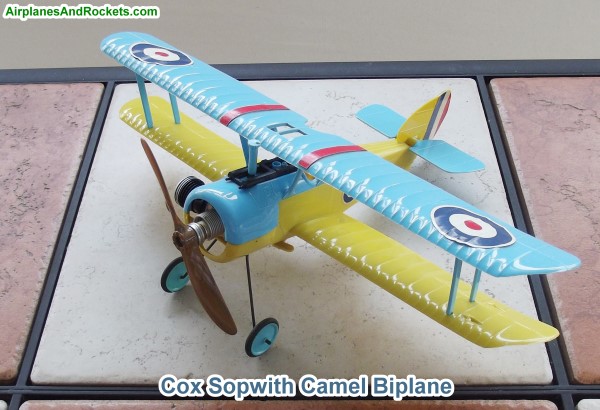

I can't blame you for wanting to fly your D-VII.. or the Skyraider. If you can find an un-cut hayfield and bring a pitman for a hand-launch, even the worst crash might be cushioned by the tall grass. I had a Cox .049 powered Sopwith Camel as a very young kid (1968?) which was flown mostly by my Dad. The lines were probably 20-25 feet long.
(internet photos)

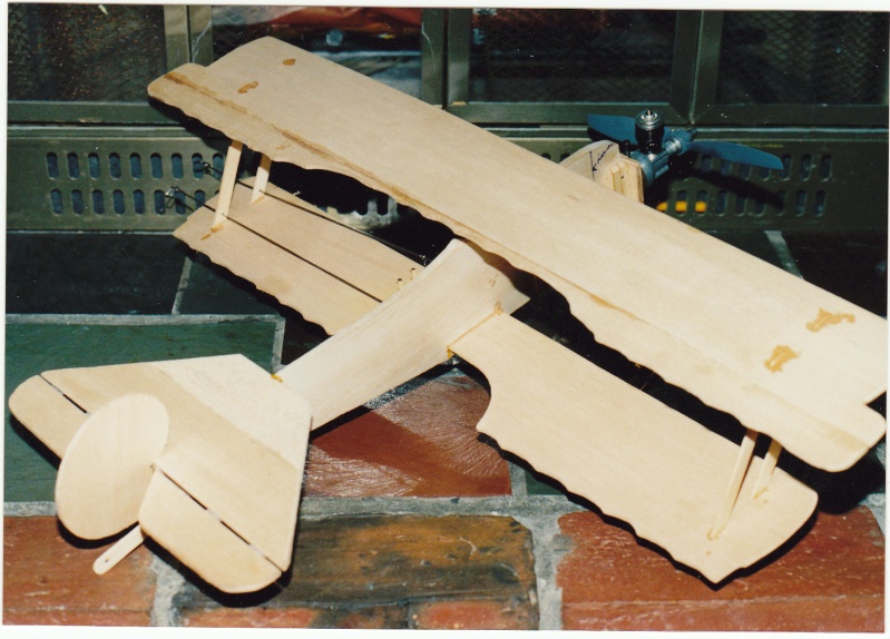

I have to agree with George on building one from balsa though. It will fly sOoOo much better! I was in the process of building a Sterling-kit DR-I (23.5" w/s) and decided to trace the top and middle wings and tail-plane pieces onto 1/8" sheet-balsa for a "sorta'-scale D-VII. I used 1/4" sheet-balsa for the fuse. I had a LOT of fun with that model! It towed banners, busted balloons and with it's large, thin lightweight wheels; did great R.O.G.'s from a freshly-mowed lawn.. every time.

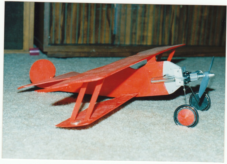

Shown here with a Babe Bee (early) The wing struts and tailskid are popsicle sticks.. and the main inverted-V gear is 1/16" music-wire mounted to the firewall.. well-forward of the C of G.. which helped both; take-offs and landings.

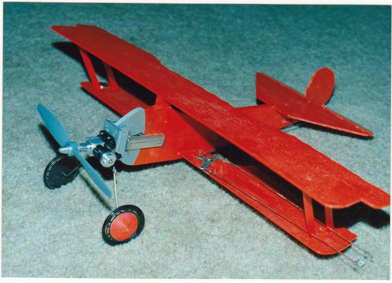

and later.. with a product engine/wedge tank.. circa 1992

I notice the thrust line of your Bipe is more or less aligned with the fuselage.  Not so on these Cox models as they have a lot of down thrust built in the engines.  Curious.  I also like the built in the fuselage fuel tank.
I like that Camel.  There is a partzer on ebay just like it.
