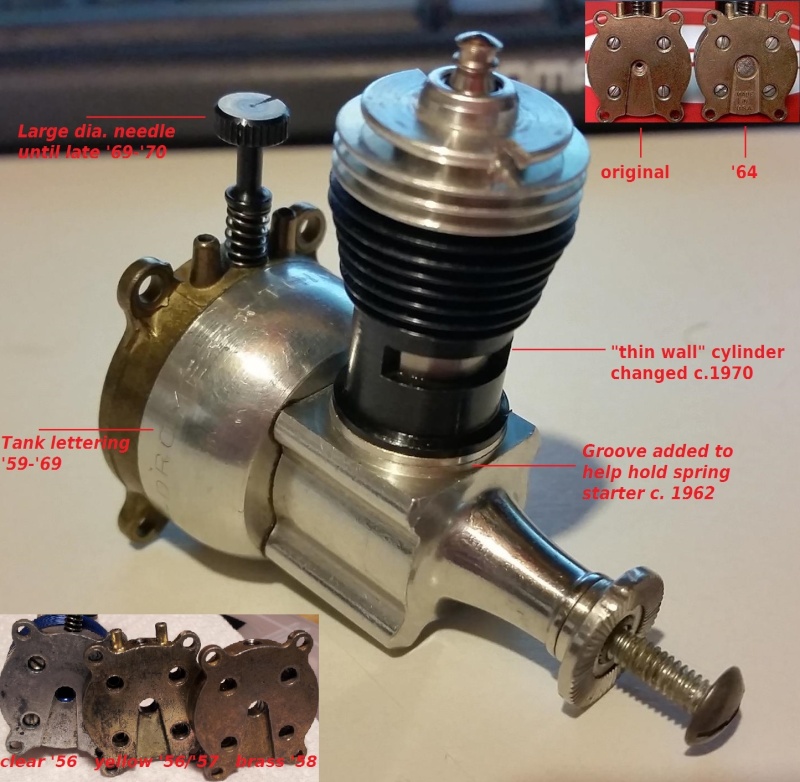

It's info I've learned over the years, thanks to fourms and collector friends. Remember years are almost always approximates, if Cox ended production or changed something, it might be months before they ran out.
I think i'll put together a basic "Bee ID" chart, it would come in handy.

Post  Mark Boesen on Tue Feb 03, 2015 10:23 pm
Here's one i cooked up, it needs work...

Post  crankbndr on Wed Feb 04, 2015 8:00 am
All this info and much more is on Marks site.
Very early Bee, with 3 piece piston. It has the fillister head screws so not the first Bee
One of the first Golden Bees, also has 3 piece piston (sent it to Kim for the race)

Post  Mark Boesen on Wed Feb 04, 2015 11:28 am
i wanna do one on the glowheads...but thats gonna take some time. I also think it would be neat to have a full page "flow chart" of photos of all Babe Bee changes from '56 to say early/mid 70's.

Thanks "again" Phil. They do seem fragile almost to the point of being sacrificial.. like a case-gasket. That's ok.. I have a few spares in the 10-piece "bulk-discount" pkg. I got from Bernie. The backplate/snorkel assemblies came that way too.. in 3-packs.. of which I bought two.. along with two 12-pack backplate screws. Enough for 6 engines. Wanting to give Matt some business too; I bought 6 needles, some Mylar reeds and a Tee Dee radial mount from him. Dan McEntee also sold me a bunch of NOS Perfect wedge-tanks in the small sizes I used to run.
I've had some engine parts broken-down separately in parts-organizers for the longest time. Crankcase assemblies, cylinders (ID'd) and pistons reset. Maybe 8 engines-worth, from various Bee's and product-engines sourced over the years. Tank-bowls (5cc and 8cc) and their associated backplates/needles/screws are in another organizer. No traceability to the original assemblies whatsoever.. but that doesn't really bother me.  I'd gotten away from running tanked-Bee's on my model airplanes. Instead of acquiring additional complete engines.. I reconfigured the ones I had to suit my needs. I'm sure that these new backplates will work as well as the old ones did for me. I'm eager to test balloon-tanks too.
Eventually I'll design a modular firewall that will utilize the snorkel/choke-tube. I actually like the design/function even though it's obtrusive when compared to a conventional flat/radial mount. It's really the first effective application of a choke for the Bee engine.
