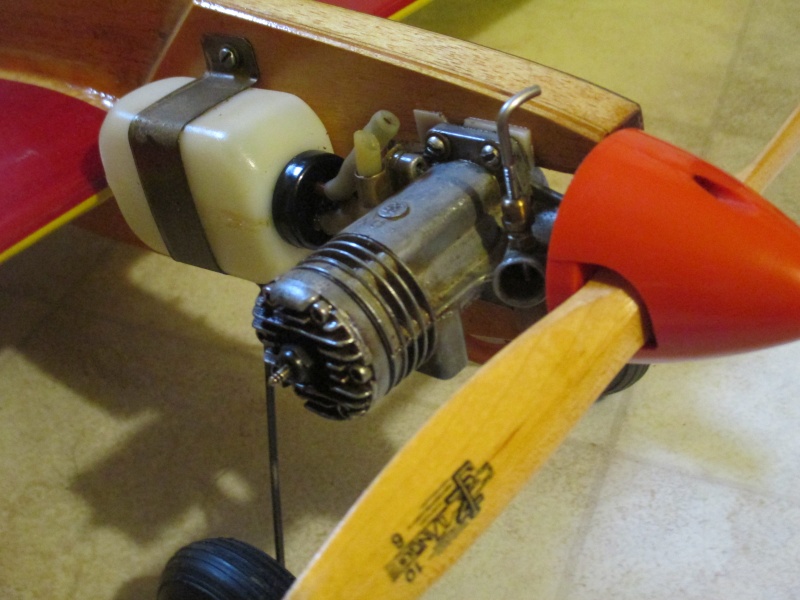

Decided that I want to give stunt a try so I ordered up a Twister about a week ago and it just arrived "Nice Kit" so I'm in need of some advice since this is my first C/L model larger than a .15 and my first full line stunt model. I was thinking about a fox 35 for power. Any suggestions? (Bandit)
Here's a pic
Here's a pic

Flight Streak ARF been looking at one of those. As far as the FP I have a later model FP (ABN) but it's in need of a piston/sleeve set and speaking of that, you wouldn't know where I can lay my hands on a set? It's been heck trying to find one, even for the tower 40. (Bandit)Mark Boesen wrote:Opinions are like elbows, pretty much everybody's got a couple...

Cool thanks, I plan on using my FP40 in it after doing some configuring I may eventually put a fox in it. Its gonna be a while before I get started on the twister since I'm going to use a Flight Streak to get my hands wet and get some practice in first since I believe in taking things slow. I will defently take your construction tips into consideration.stuntflyr wrote:You've gotten a lot of good info here, Bandit.

Using the FP40 in the Twister is a good way to go. There are a lot of stories about them out there, but a stock liner, a C/L venturi and spray bar/needle valve, and a tongue muffler with a pressure tap installed work well. A good tank (I use a square r/c clunk tank set up for muffler pressure) and fuel make them run fine. That's the one you use an 11x4 prop, they spin high rpm so the low pitch keeps the speed at the right place, let her rev. I wouldn't send it to anyone like Tom Dixon to have the liner "reworked" for different tiing, they usually ruin them.

Yup they begin to peel, The early plating process that OS used back then usually didn't take well to porting. I also have an old OS Max-H .40 that i'm thinking about trying on the twister too, I've had it since the late 70's and it tough me how to fly . I've just put new bearings in it I have a venturi for it already too. I plan on going through the Flight Streak when I get it but it's gonna be a while since it's on back order everywhere. (Bandit)stuntflyr wrote:Bandit,
