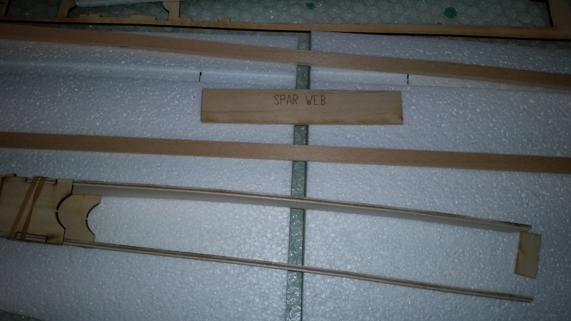

a few photos of the Li'l Hacker II kits
Not in the pics is the large qty of SLC...plenty to do both planes with a bit of screwing up learning to use the stuff
SLC = SuperLite Covering is a great and maddening product ...maddening in that you always need three hands and a draft free , dust free environment. More on this when I get to covering these kits

Fred, here's my take. While I built many per Phil's instructions they never suited me well. I went over Phil's house a few months ago to get some problems sorted out for me. I feel the Hacker wingspan is too narrow. Phil just made me the same cores with a wider wingspan but same root and tip. I can now trim and shape the wing panels as desired and still have a decent wingspan. Keep in mind that Phil designed this plane for the beginner. When I did use the Ply fuselage body, I removed the entire center section of the ply top and bottom leaving only 1/8" of material down each side. The plane will build tail heavy if you use a Norvel. You will need almost 1 oz of nose weight. I elected not to use weight and remove as much material I could behind the cg. The problem with engines like the Norvel is that you need to use a Dave Brown R/C mount. They vibrate and this not only robs tons of horsepower, the mount breaks all the time. I broke 6 of them. I had a mount made from aluminum to avoid this problem. If you build the plane like Jeff does, you can use aluminum Driskill mounts on the noseblock and try Norvel's, Stels, Tee Dee's all on the same mount.
Let's go to the parts. Use the spars to light your fire place as they have no place on a combat wing. Use hard balsa, you will find it easier to sand down and lighter. Just use strands of carbon tow under the spars like Jeff does and thinned white glue. Don't use Gorilla glue or epoxy. I only use Epoxy on the nose block for fuel proofing. Phil only gives you sticks and pieces that fit into the box. You will find more than likely the spars he provided are too short. He will tell you it's not needed. I'm telling you they need to go wing tip to wing tip. One ground pounding and the wing creases directly where the spar stops. The elevator can also be trimmed waaaaaaay down as I feel it's too wide only adding to the tail heavy condition and it can be angled in to also lighten even more.
Using a small Contadina tomato paste can, cut the rolled rim off of the top of the can. Heat the can up on the stove and using gloves core holes directly behind the spar. You can cut 3 holes on the inboard side and 2 on the outboard side. The outboard side will also have you bladder compartment. Obviously this is done in a symmetrical application. Coring the holes will save you almost 5/8 oz. even moving the cg more forward. Instead of using metal tubing for a replaceable tail, use the Dubro antennae housing like Jeff does. It's lighter than brass or copper.
My friend Larry I fly with eliminated the shear web your inquiring about upon my instructions. Larry's plane is built using the wood fuse in the kit. We slide the wing forward a bit and cut off the excess material that was behind the trailing edge. I'm thinking we almost cut 5/8" off the fuse if memory serves me correctly. No wing failure to date and it won't happen regardless. Look at Jeff's planes, none of them use that piece of wood. That can also be used as kindling.

Based on your advice to Godsey I already cut Balsa Spars full length. I always use TOW under the spars and can attest this adds a bunch of strength in compression and tension
I have small hot wire cutter and templates to add the fuel cut out and any lightening holes. However the sharp hot soup can trick will be tried as it sounds a lot faster than my current method
