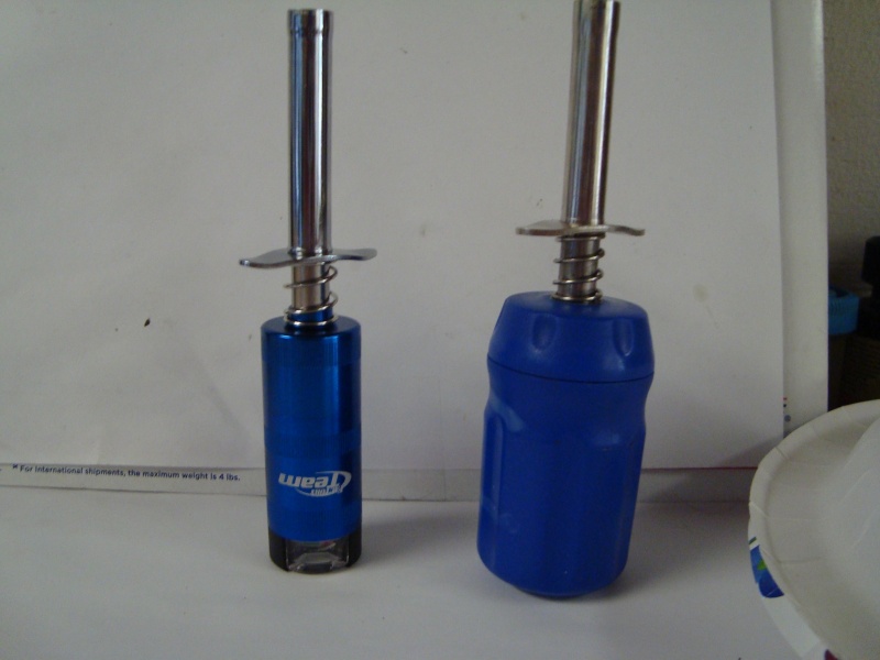

Post  crankbndr Thu Mar 26, 2015 8:28 pm
Thanks for the help, the one on the right came with the MGT8 and the one on the left got from Tower.
Like the new one better for obvious reasons, it came with 1300mah battery and has a gauge that I don't fully understand because it came with no literature at all.
Truck still runs like bat out of hell !!

Post  JasonB Fri Mar 27, 2015 12:57 pm
The gauge is a simple ammeter, shows when attached to a good glow plug that current is flowing. Good plugs should put the needle in the green range. Mine, the meter gets a bit sticky sometimes, and a little tap may be needed to get the needle to move, but it's a good visual confirmation that the glow plug is intact - especially on engines with mufflers that prevent you hearing the "sizzle".
J

Post  gcb Fri Mar 27, 2015 6:46 pm
If you can't hear the sizzle or see the glow, hold the prop and turn the engine over slowly. You should feel a "bump" meaning that is ready for a serious flip.
George
Edit: Oops! Almost forgot the most important part. When looking for ANY replacement battery check the ampere-hour (AH) capacity as well as the size (Sub-C). Sub-C is an external size and ones with a lower AH capacity may have a smaller battery and a spacer inside the Sub-C shell.
