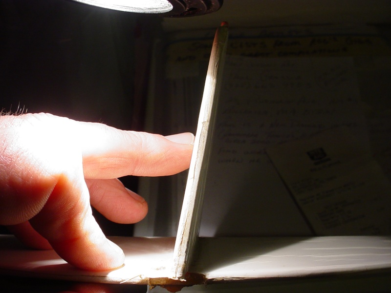

I have some structural concerns with the model. As you can see in previous photos.. the outboard wing-strut came off. It didn't "break off".. but it needs re-gluing. Structurally; it doesn't look like the butt-joints provide much shear-strength at the wing attachment point. A rough landing would surely break them.. or at least break them loose.

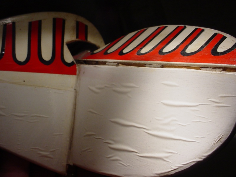

The fin/rudder is loose to the stab.. flopping by stretched monokote. I pinned the fin/rudder on my Rare-Bear with two toothpicks.. using a drill in a pin-vise to make the holes. The toothpicks I cut to approx. 3/4"L. and installed the butt-end in the fin.. leaving the pointed end to punch-mark the locations to drill the fuse. The pointed ends guide the pins into the fuse-holes.. and really strengthens the fin.. once glued-in.

Dad used DuBro pin-hinges on the elevator. Tedious work.. I've used the small size on several 1/2A models. Now would be a good time with these tail-feathers off, to run an iron over those wrinkles using the edge of a table for support.
