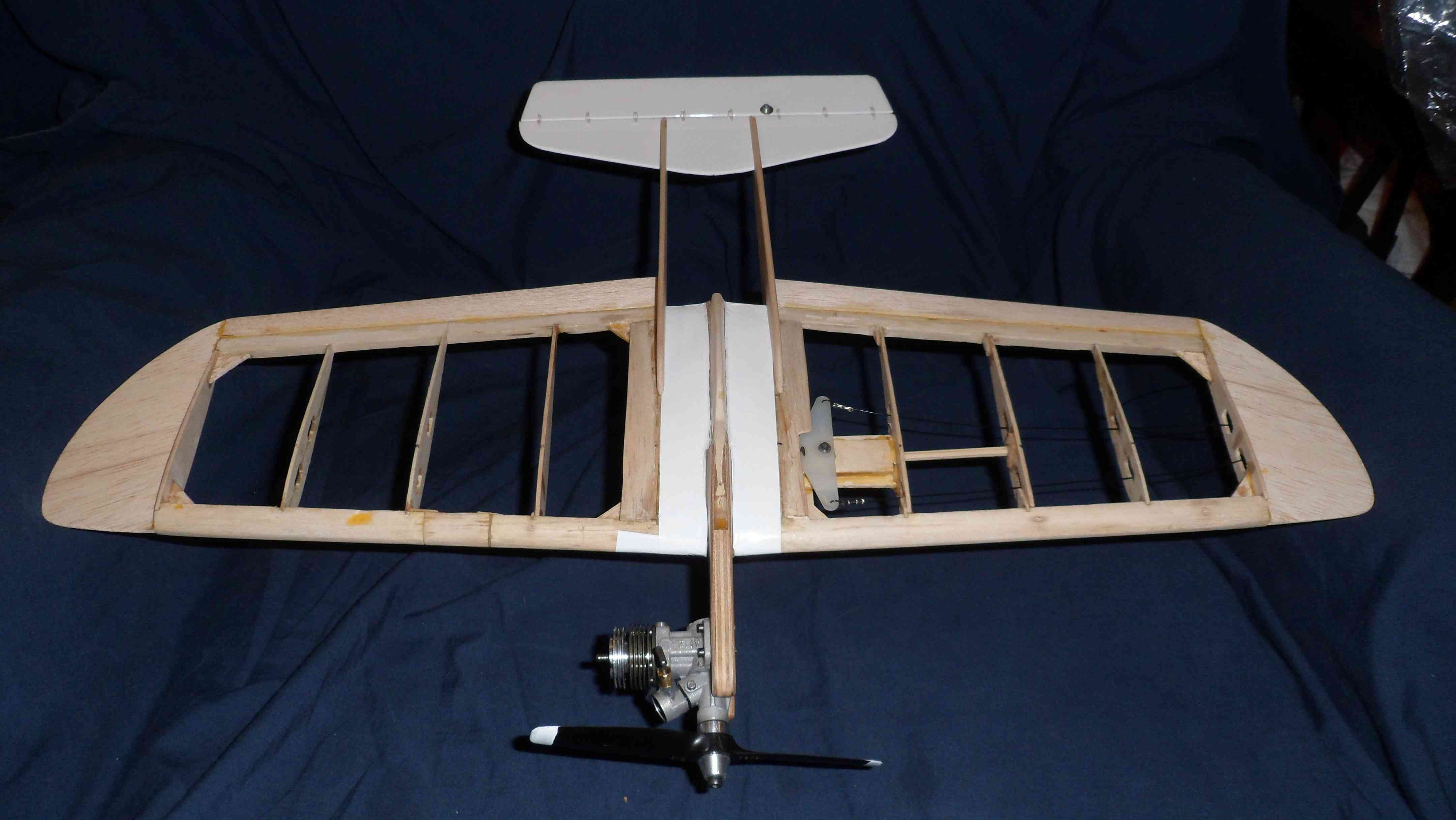

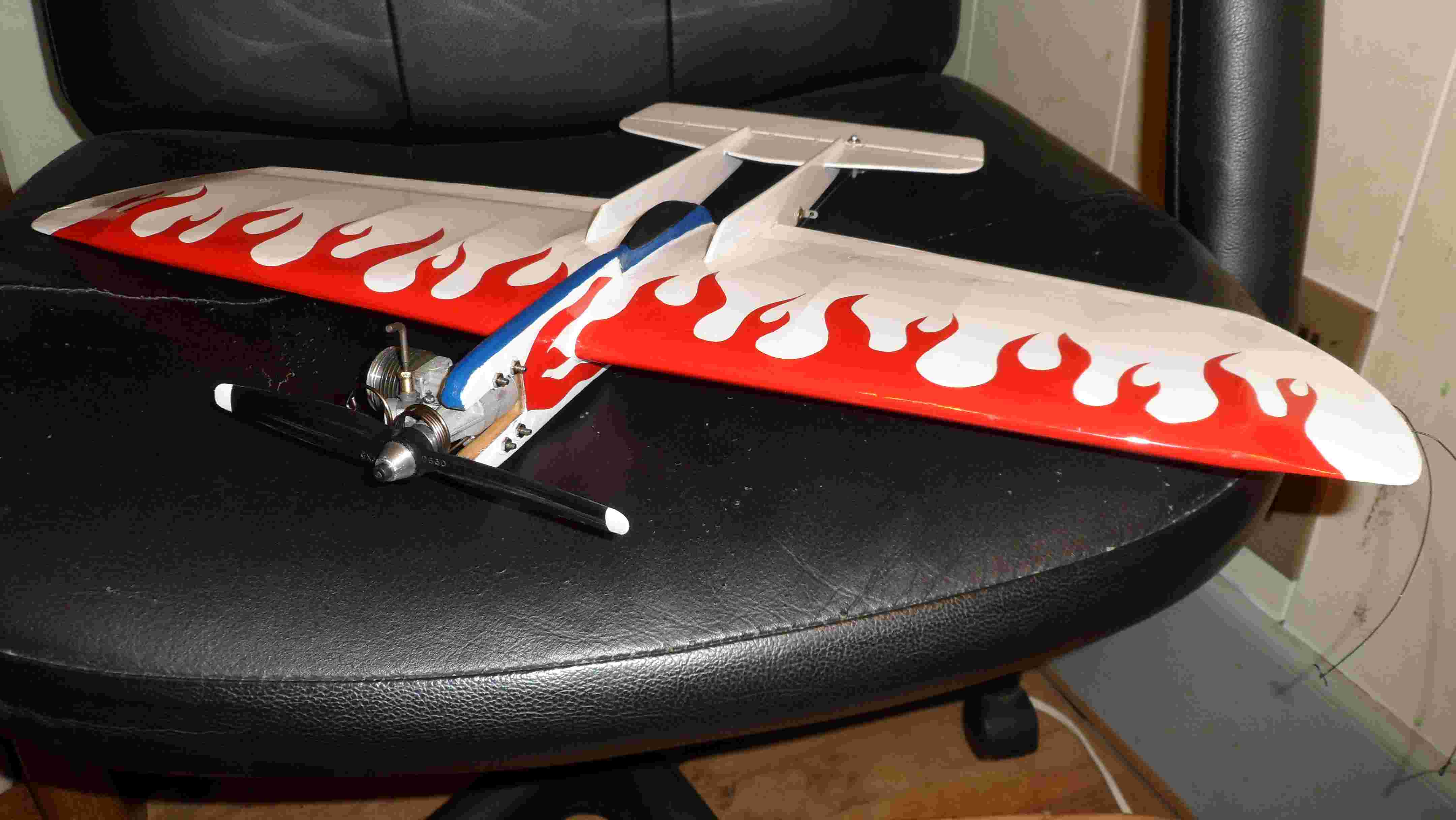

I have a huge build thread on the Bean. It might be at RCG. But I knew nothing about building a quality model at the time, and that's the plane that got me on the right track. Boy did i ask some dumb stuff... and resisted advice... man was I hard headed. I'll see if i can dig it up. I bought it when I decided 46 years was too long to have been flying and still not know how to fly a loop.
Meanwhile here are before, during and after pics. See my avatar, guess what that is..
Young and beautiful
Later in life
End of life and resurrection. After having yanked the bellcrank out of the center and cleaning out every inboard rib... in the middle of a loop. Notice the added wing area at the TE and tips.
Reborn as The Refried Bean Norvel .061. Now this is a true pocket rocket!
