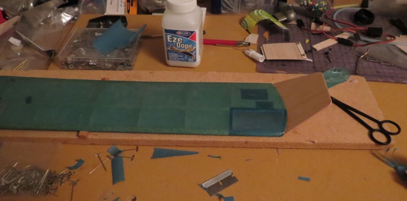

I used to like the "scent" of Dope, but nowadays I mainly get a headache from it...
Lately I've used the odourless "Ezedope" instead. It leaves a more shiny surface but it does shrink tissue with about the same end result as with dope. It is fuel resistant once fully dried out.
Here is a tiny free-flight model I built when I was a kid. I recently rescued it from the attic and patched up the hangar rash by using tissue from the same time era (not quite the right color unfortunately), but this time with Eze-dope.  Here is the end results, re-maidened during this easter after +30 years of being stowed away...

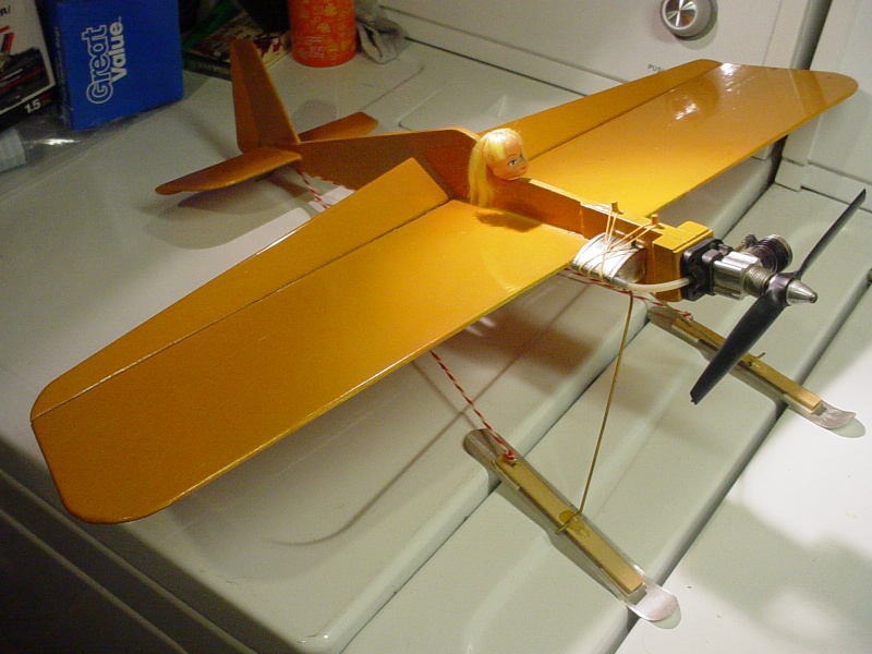

I've used a few different rattle-can finishes. Remember Pactra's "Formula-U"? I still have a few old cans of it. I used "International Orange" on my Barbie Plane almost 25 years ago.. and flew it a lot! The gloss has held up well.
An alternative to dope? Dsc02410
I've always been in the habit of "spritzing" my glow-powered models with cleaner.. immediately after the final flight. I'll throw a rag over the engine.. and spray the model with w/s washer-fluid that I keep in a small pump-sprayer in my flight box. The alcohol cuts the oil.. and I think the evaporation process might carry the nitro with it.. not sure, but it does a good cheap job of cleaning IMO. The longer you leave that fuel-spray on there.. the more you're testing the limitations of your finish. Two Cents
