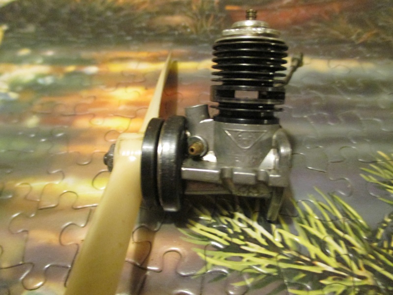

My latest ebay buy was this wen mac mark XIII. The guy had a reasonable buy it now on it so I snapped it up. It has electro stencilling on the crankcase. One side reads "015 mix" and the other side reads N_ _ 049. I cant make out the other letters. I replaced the starter spring with a bomb unit and test ran it yesterday. I have gotten a little more performance out of the testors variant, but this is the fastest wen mac I have so far. With a 5 1/2x3 white tornado and 20% nitro it held high 16600 rpm to low 16700's.
