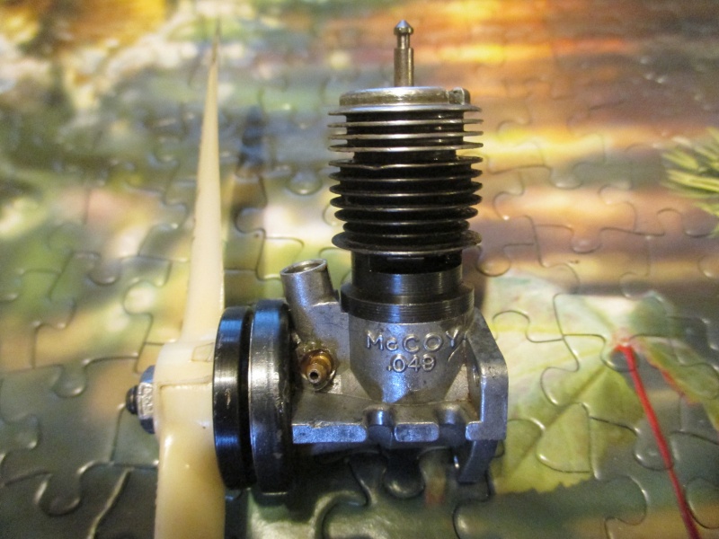

Post  chevyiron420 Wed Apr 29, 2015 6:37 pm
I modified an old mecoa conversion head into a clamp. It had been milled down to far for any other use. I know you can modify a old glow head but I wanted the extra cooling fins. The poor thing looks like crap from the corrosion it got in storage years ago. The engine is a Testors McCoy, 5 1/2x3 tornado prop, Merlin drop in plug with two shims. I dropped the nitro down to 10%. Over all I am happy with it. I made several 1/2 oz. runs and it made 17500 pretty consistently. The needle is pretty touchy with the 10% but usable. Just out of curiosity I tried the 20% and it went 18600 and got hot fast, so I shut it down. I dont know if I am going to try shimming the cylinder up or not. It runs good on the 10%, I may just stick with it.
   drop in plug in a wen mac Img_0222
drop in plug in a wen mac Img_0223
drop in plug in a wen mac Img_0224
