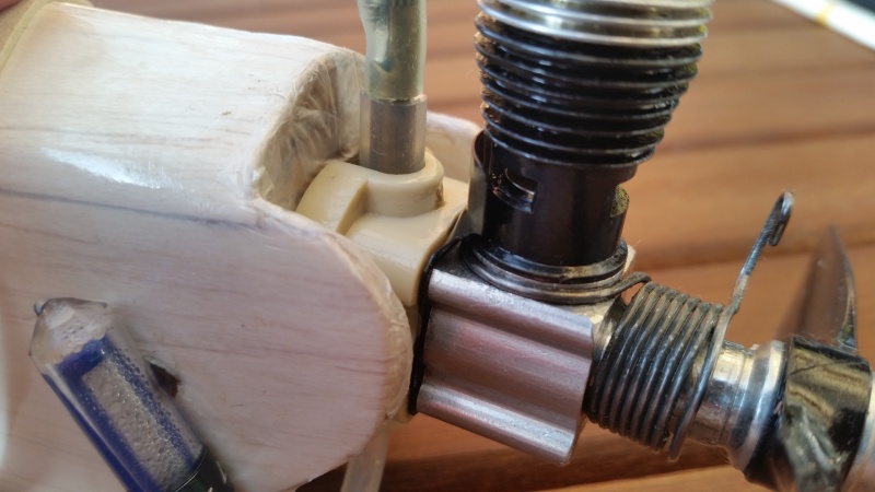

I bought this Lil Roughneck from Selecthobbies some time ago to build it once its predecessor retires. The previous one was powered by a TD 020 and flew quite well.
I thought I make this new one as a common R/C platform for my 010, 020 powerplants ( the Lil Roughneck is said to fly with only a 010 on board, but I have never tried) and the 42 years 051 reedy (pictured while in duty) that tossed me back into modeling 5 years ago when I found it in the garage neatly preserved form the 1970-s. (I sang some songs about it on various threads. It came with a Super Sport trainer with an 051 piston/cylinder combo instead of a 049 product engine setup, for reasons unknown to me)
I built it between 9 am yesterday and 3 am this morning ( my back aches bitterly)....I designed the firewall so to accommodate a couple of different COX bacplate designs...in the worst case I return to the 020 to pull it.
This one weighs a tad less than 8 ounces and I wonder how the 051 will fly it...I go maiden it as weather here is just fine.)

Thanks for the link, I can confirm these low-wing small R/C planes are often tricky and will react with furor if small inacuracies in angles and dimensions are built in inadvertantly in your plane.
Mine this morning during the maided flightn - before I offset the engine angle by 4 degree - simply did not react to the rudder and elevator and kept pulling left until it crash landed in deep grass. The assembly instructions warns, anyway, that the rudder needs to be widened otherwise it will not make its work)
After the engine angle was offset though, now it is as tame as a kitten, and with the 051 reedy as fast as a swallow.
I put an exhasut deflector on my reedy and it looks like you the backplate gasket needs to be put on its both sides otherwise the engine will inhale false air.

What is that blue thing on the side fuel filter slash port for refueling?
1/2A Nut- Top Poster
Posts : 3329
Re: Lil Roughneck 020/051
Yes it is but the fueling stub is blanked as it was broken.
Posts : 4551
I am glad U asked I was wondering the same thing I presume you have a tank inside the fuse ? the more I see these small planes I want to invest in something that would soot my purpose around the house here to fly but would have to be slow to start with , being inexperienced
Posts : 9724
Sure I have the tank, a party balloon, holding some 3 ounces of fuel, in the nose. With a TD 020 or Pee Wee this can be a convenient plane to start with "around the house" but you will sure need a larger open area especially with a 049 on the nose. This plane will fly at a speed around 50 miles/hour or even more..
