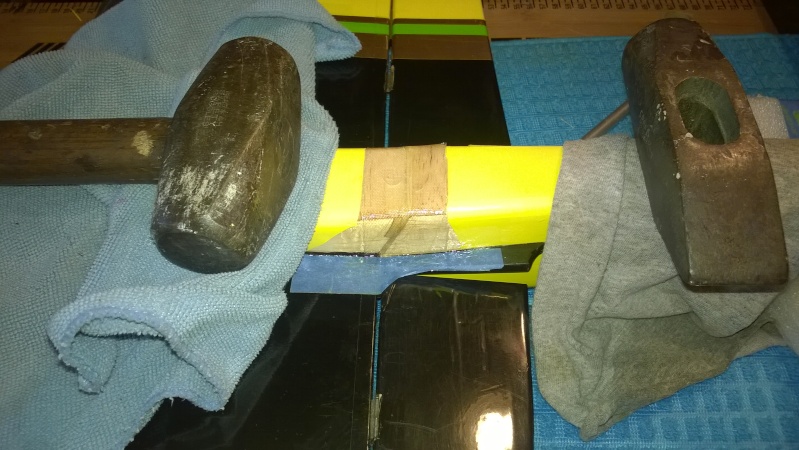

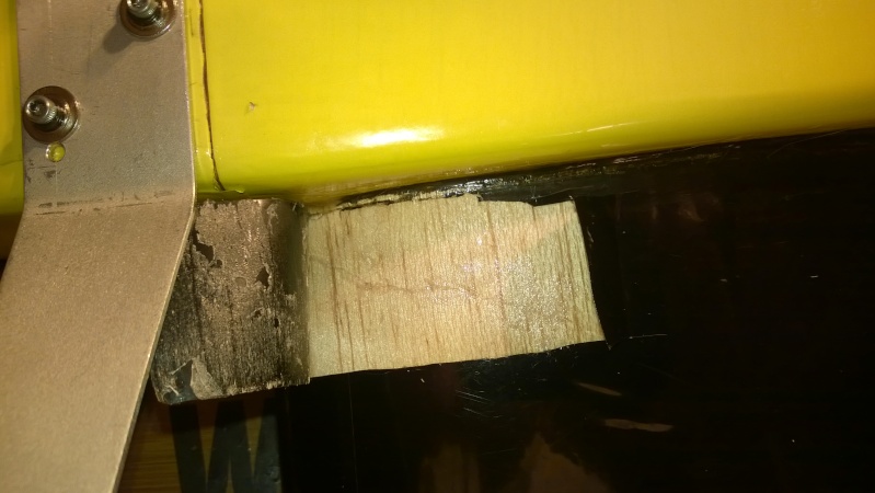

I fixed the Oriental's battle scars.
LE crack before repair. You can see holes I punched so I gould press gorilla glue through it.
I put a good strong fillet on the root next to the crack(not shown), and painted the area with epoxy for good measure, and so it holds the original strip of covering down. It should be an invisible repair.
Next to that was where I added a fillet to the root.
Here's the fuselage repair
A 1-1/2" x 4" strip of fiberglass and epoxy. I flexed it and made sure I got glue into the joint too. Then weighted it to hold it closed while the epoxy set. It's strong and the stab is still in alignment.
