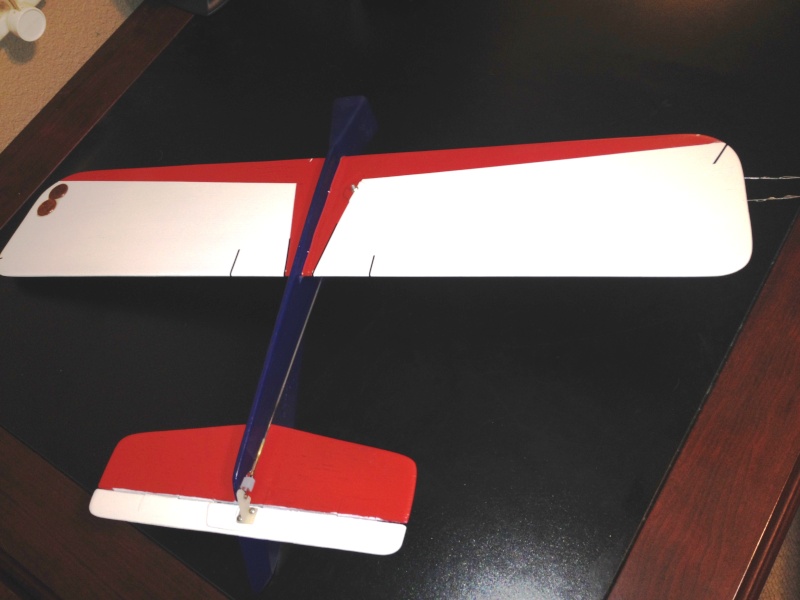

The time has finally come when we can call this build COMPLETE.  It's been a labor of love for both of us.  Nicholas did all the work except for leveling the wing and stab while gluing and taping the paint lines.  I'm proud of him for the patience he showed.  It took us awhile, but the final coat and controls are on and the wait for the maiden flight begins. (Paint curing.)  He chose the paint scheme after days of thinking about it, then was quite decisive on the colors.
Here's the finished L'il Wizard.  Will post more when we get it flying.  It weighs in at 6.7 oz. with CG about 1/4" back from the LE which is a good spot to start with I think.  (May be over nose-heavy?)  We chopped the front end of the fuse 3/4" after some reading.  The only thing that doesn't sit right with me is the rudder is really flimsy side-to-side.  It's solid where it connects with the fuse because we added the nylon or silk material but the top 1/2 will be easily cracked off with any force.
I am forgetting why the original Goldberg Wizard advertised itself as the only 1/2a that flies on 52' lines.  I had one and flew it at 52 feet.  I remember a lot of line drag but it was easy to fly.  I think I'm going to start him with lines around 38' to 40'.
The black widow is just for the photo, we'll be flying a Baby Bee until we're ready for more speed or maybe a loop or flyover.
Thanks for all the guidance and support.
Greg & Nicholas
Oh, I have to take some pics of my Skyray that I built at the same time, soon.
Check the black nose

rsv1cox wrote:Love the last picture.  Nothing turns out correctly unless you hold your mouth right.  Smile
Tip weight, rudder off-set, and yellow safety prop.  Ought to be a flyer.
I'm missing Florida, red mulch, palms, green grass.  I spent the better part of fifty years down there.
Oh yeah, and things are really green here now since we've been getting our daily rains! Plus, 95% humidity that hits you like a wall when you walk out the door any time of day. That's okay, I'm a native and comfortable with it. I just change my shirt twice a day :-)

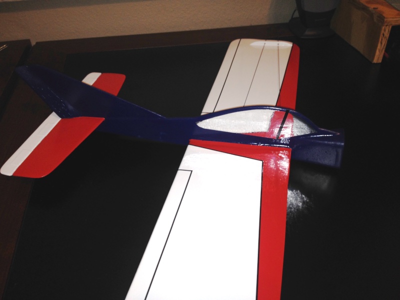

Alright, I finally wrapped up the Skyray tonight.  We've been busy flying Nicholas' Wizard and relearning how to fly and getting our engines going.  This weekend we'll maiden the Skyray.  Being my first build as an adult, I wanted to take some extra time and make her nice and pretty.  I borrowed the paint scheme from a plane I found by Googling 1/2a's and I got a good amount of input from CEF people.  Thank you!  I had some old mirror finish monokote I used on the canopy which I thinks sets off the paint job nicely.  This would've looked a lot better with an engine on it but I wanted to get this post up.
Weighs in at 6.1 oz with the engine.  The only mods were a larger 2-screw elevator horn, heavier control rod with brass coupler soldered on so I could use a 2-56 threaded steel clevis, a beefed up elevator horn platform and a screw and bolt thru the wing for the bellcrank vs. a wood screw.
Haven't checked the CG yet.
Oh, and... I finally got the Stuka in the air Sunday morning.  What a victory!  Nicholas has been getting more comfortable in the ring with his Wizard with his strong running Babe Bee and can't wait to try a loop.
So we've gone from no planes to 4 planes flying in a matter of a few weeks.  It's been exciting and I so thankful the boiy is still showing interest.  I think he might be hooked.  He wants to start another build already.
Thanks again for the support, tricks and pointers.  Greg
P.S.  My dad came out Sunday and is showing some interest in getting behind the handle so maybe we'll have 3 generations flying before we know it.

Nicely done .... time to get out and put some laps on all those planes!

Wow from 0 to 4 in weeks cool looking Skyray , Greg good to see the Family Fly Team coming together , Ya'll be playing combat before you know it Very Happy Eric
