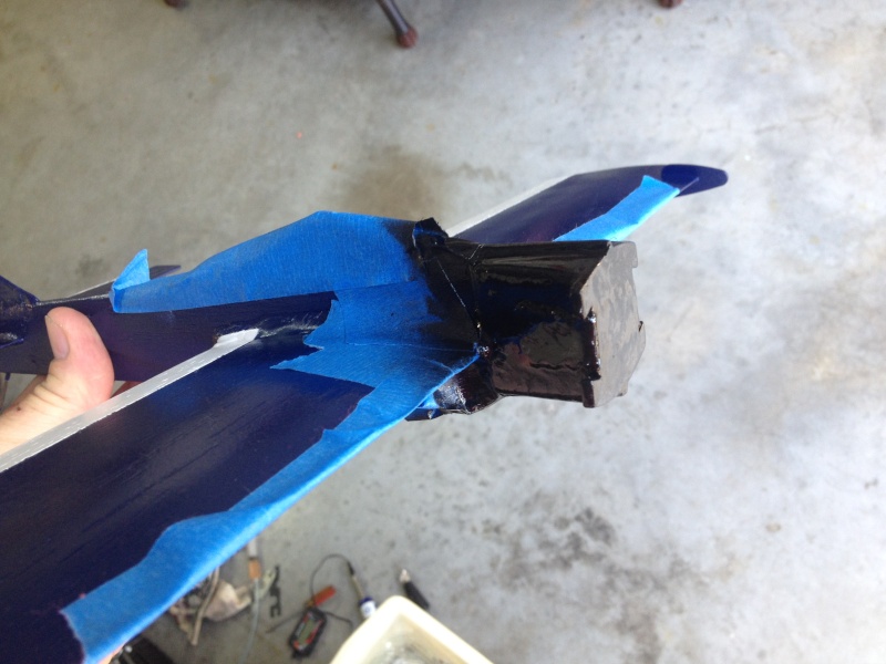

Cribbs74 wrote:
The Wiz will loop, but not well. It needs to be taken almost overhead to do it. If the boy wants to loop a new plane is probably in order.
The other option is to take some of the nose off.
Ron, by saying taken almost overhead are you meaning it would be a giant loop but started at normal altitude or would you be starting really high and basically looping overhead, or something else?  I'd like to understand.
The nose blocks are touching the LE as we did shorten the nose 3/4" and that was after whacking off the beam mount nose too.  The plane weighs 6.2 oz with engine, dry.  My deweybird weighs 8oz but has a lot more wing area.  Not sure how 6 oz is relatively and if that would allow for some tail weight.
I'm not set on having the Wiz loop, it would be fun if I could get it to then teach Nicholas how but we have other planes that will, once I learn how first.
Greg
Here's the nose of his Wizard:

Greg where is your balance point at the wing tips , I find that 3/4" back from LE is a good usually for 1/2a , less will start getting squirrely , that's where the fun begins but too much is unflyable  , I start my trainer loops (outside) at about 6' if your not sure here are some patterns just for fun copy save print  Son's First Flight - Flight Report - Page 2 Cl_aer11

That's perfect Eric! Thanks for the stunt guide.
The CG on the wizard is about an inch back and on the Skyray 3/4". The Skyray flies very smoothly but is very responsive to input too. Nicholas urged me to go for my first loop last weekend and I went for it. Felt great!! Actually did 3 (not consecutive) and on the 3rd collided with the earth somehow. No damage.
Next... have to figure out the sequence to getting Nicholas doing loops... not with his wizard but I think with the deweybird.
