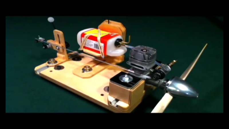

getback wrote:you like shiney ck this engine schroll down
Oh yeah, that's totally sexy!!! Bling bling baby! But see how the black cylinder is the only non-shiny metallic part? That bugs. Lol.
So I was looking around and I found this style station, which is complete sex! The name of the guy that builds them sounded familiar so maybe he's even a forum member, it wouldn't surprise me. But this is kinda the station I have in my head, just a bit larger and more adjustable for various setups. I love the versatility here. Even the throttle attached to a shift lever is remarkably like what I had in mind for setting up today, just not quite as long. This mans mind functions just like mine, and I friggin love it!  Thumbs Up

Yeah I'm just an engine guy really, so I realize my needs are different than most people here, and my experience is going to put me in a different category as well, but maybe that's the "outside of the box" aspect that's needed. I should find some pictures of the vape building station and tools a made with plexi, I've been on a plexiglass kick for a while, which is odd considering my background as a metal fabricator. Haha.
