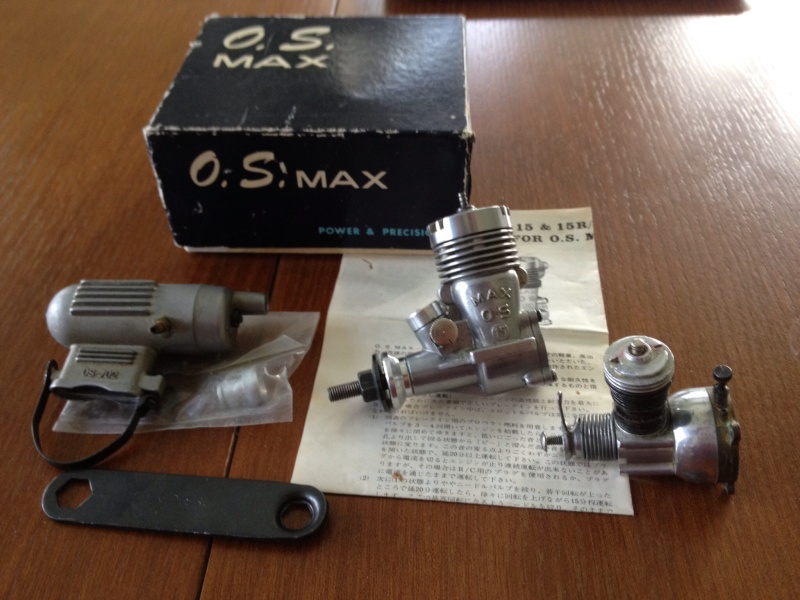

Post  KariFS Wed Jul 22, 2015 2:22 am
gcb wrote:
KariFS wrote:What size of a model should I look for my mid-70's OS MAX 15? Any examples?
First question is, which Max 15?
In 1975 OS dropped the steel finned Max-III for a new OS .15 with a drop-in liner. Do you need to use a muffler (extra weight)?
Here's a picture of the engine:
A model for an OS MAX 15? Image11
It seems to be the later model with aluminum fins. I think I will use a muffler, as I want this plane to have longer flight times and since it will be for slightly more advanced training, I will most likely fly it more too. (EDIT: I don't mean that the muffler would give a longer run time but less noise means more tolerance from people nearby and less ringing in my ears afterwards.)
The muffler (#702) weighs about 36 grams or 1,2 oz, so although it feels light, it actually makes for 25% of the weight of the combination. I guess I could use the muffler while practising and when I feel confident, I could remove it, thus moving the CG back a little and ending up with a better power-to-weight ratio.
Thanks again everyone Smile
Last edited by KariFS on Wed Jul 22, 2015 2:44 am; edited 2 times in total (Reason for editing : Clarification)

Post  KariFS Wed Jul 22, 2015 2:27 am
