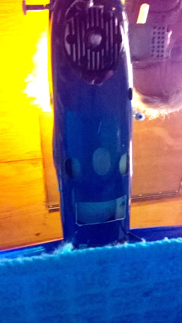

I opened up new cooling vents in the cowl. It made all the difference I need in my engine run. It still speeds up about the time I start the horsepower maneuvers, but that's okay with me, it's probably my non-uniflow venting. I haven't got a lap time on either of the two conditions yet. My launch RPM is 10.8-11K, just like the Oriental. Both planes weigh about the same, 43 and 45 ounces, the Oreo being the latter. And they both use the same prop.
Here is a picture of my new vents. Before, it was all blowing out of the back of the cowl, right in front of the LG wires. I just realized that's hidden in the picture by the cushion the plane is resting on. What you see under the holes is the plastic fuel tank with a white foam rubber pad on the right side.

It's totally normal for a standard vent tank to lean the run as the head pressure changes. As you probably already know.
