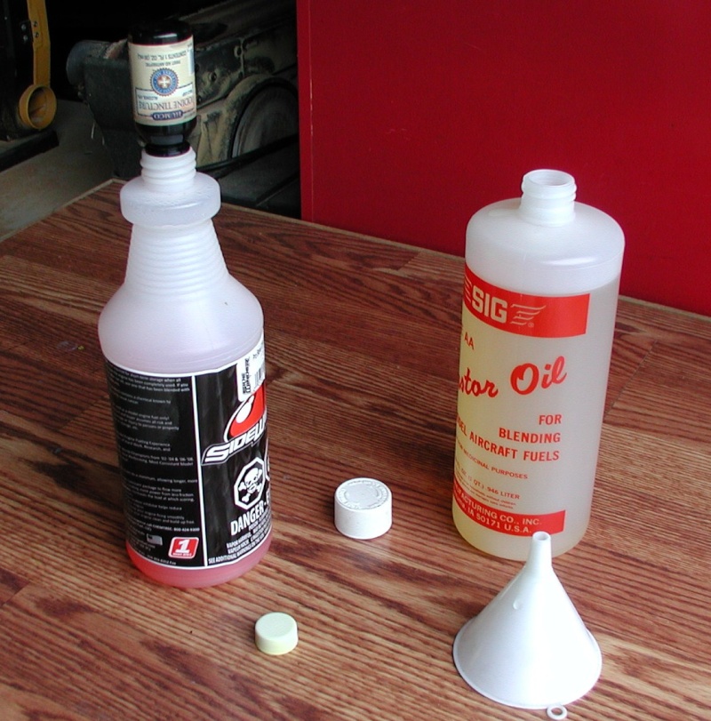

Using Larry's conversion calculator I mixed in four ounces of Sig castor oil into an existing bottle of Sidewinder fuel @ 20% nitro and 10% oil. Having nothing better on hand, I used a one oz iodine bottle flushed out. This stuff on a cool morning is about the consistency of honey, resisting the urge to take a taste
I added the four ounces.

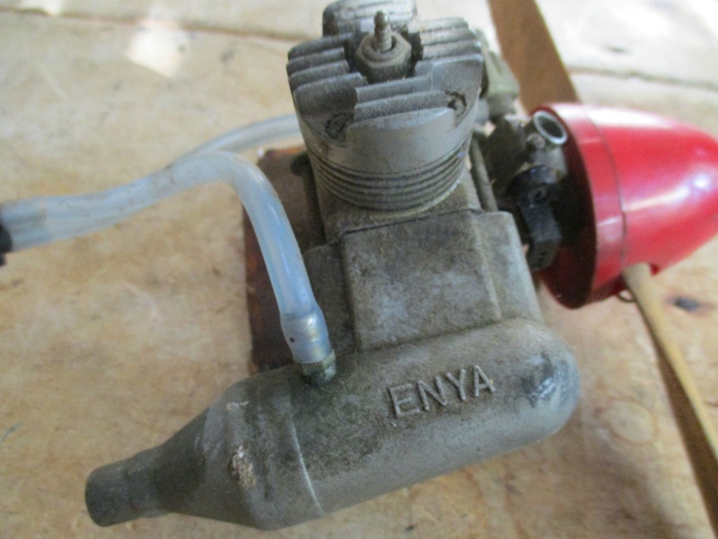

I had just received this C/L Enya .09 and using it gave the new mix a try.
Previous owner evidently had painted or touched up the model with the engine on it. Lot's of epoxy on the back case too. The propeller that came on it is interesting. It's unmarked except for "Made in Japan" and D7 P4.5 on the hub. The PO also used a pencil soldering iron to etch the numbers 2348175 into one of the blades. Curious.
Using the new castor mix it started on the third flip a little lean. After running it rich for a while I leaned it out and it ran strong until I shut it down. I love these little Enya's.
I cleaned it up and it turned out nice. I have a couple of these Enya .09's. I'm thinking about scratch building another P-38.
I guess the point of all this is that I feel a little more comfortable about the longevity of my engines.

Great post. I am just about to mix in my castor oil as well, and am using the same Sidewinder fuel as you are. Just a quick question. Did you stir in the castor oil after adding it, or did you shake the living bejesus out of it to mix it?
- Posts : 3847
Re: Mixing in a little castor oil
Yes, That shake thing.
The castor is heavier than the fuel and it all sank to the bottom. Shaking it mixed it up. I think I will shake it each time I use it.

Thanks Rod, My favorites too. My first "Big Boy" engine was an Enya, I still have it, a .29 mounted on my Sterling Fledgling. It's been inactive for the past 30 or so years, but I just bought new batterys for the Airtronics so I may have it back in the air soon.
Not to worry you, but I hope there isn't a reason for that missing screw. Usually the screw threads will strip first before the case. But, it's probably just missing under the previous owners work bench.
We share the feeling of accomplishment in taking a dirty old engine, cleaning it up and giving it new life.
I have this one coming, an ebay buy for $12.95. I was the only bidder. Wonder why.
It will give me a morning or two of enjoyment crock cooking, disassembling, cleaning it up, reassembling and running. I did check that anti freeze, reading the back panel it is full strength. I just did a couple of Wen's in it and they turned out nice, but this time I scrubbed them with a tooth brush while they were still hot in the pot. Fingers got a little warm though but it was worth it.

Ooh, that's pretty cruddy. It should give you a nice feeling of accomplishment when it shines again.
I wonder what that number scribed on the prop was. Strange place for such a thing. Just stay out of the arc of those old props, we don't want you to have 2348175 stitches on your face.
I have an Enya 35 with a square venturi, but I've never cranked it. That's a brand I know nothing about. You're tempting to bolt mine up and crank it.

Rusty, I call it "Crispy", looks like it stayed in the bottom of a lake for some time.
I wonder about that number too. Why the effort. It could be someone's social security number missing a number but it could be to weak for me to see it. Maybe an ID incase it flew away.
