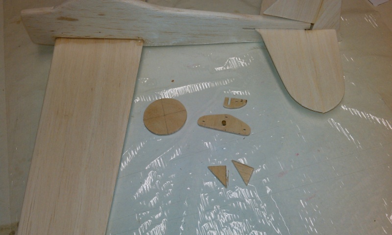

I have started on this model from scratch / plans ? any way here is what I am building for the Traveling Engine / that I am wanting to get in on and maybe fly the engine if possible, then have for an .020 that I have so it may be some what heavy for the TE ,,,, but I am wanting to test flight it with a .020 to make sure it will fly . I think I got these plans from  George in NM. and I want to thank him for letting me try and learn Spanish Again. lol!   mitsubishi zero .010-.020 size . Zero_010  getback Smile

Nice, whats the wing span on it? (Bandit)

It's 14.5" I used what seems to be B grade balsa it sands off very easy , I am thinking assemble sanding sealer 2 coats then spray all one color to speed things up , I have got 3 other planes to build one started the others in my mine Laughing . And I would like to fly sometime !! Getback

I am working on it took 3 day to glue the wing on fuse ,, to keep the glue from running while I wasn't watching !?!    mitsubishi zero .010-.020 size . Zero_b10     Just stuck the rear end on its not ready and made my own parts  1.5 " bellcrank a 1/3 of that size control arm / elev. ii changed the firewall to round the plans were for a PeeWee ....,  mitsubishi zero .010-.020 size . Zero_b12  I am thinking Olive Green the whole thing and put some Zero's on it so when we shoot skeet !! just kidding , I am looking forward to fling my first .020-.010size plane that I built . Need to clean and run one soon that 's a first too . Eric

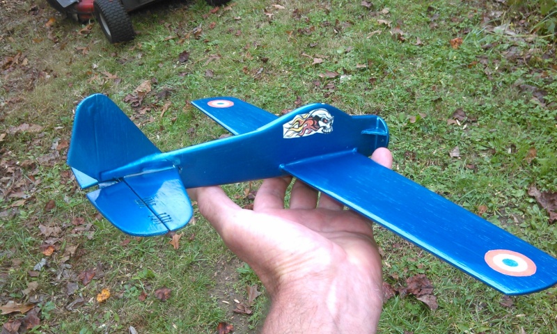

Post  getback Wed Nov 04, 2015 5:14 pm
Update time, a few decals and a spray cover of lUSTREKOTE clear > was going for more pilots but didn't  like the white back ground on the decals and the rudder half I cut out to replace the elev/stab. assy got lost ? if I find it I'll put it on .. I have a Pee Wee I want to mount to test fly before the .010T/E gets here ... To day was not a good day to spray but I been in side for a few days because of the rain and after the first pic I turned it over and sprayed then picked it up after a few mint. and had picked up some of my box at the cockpit . So here it is without the engine and control lines ... mitsubishi zero .010-.020 size . Beeman10  mitsubishi zero .010-.020 size . Beeman11  mitsubishi zero .010-.020 size . Beeman12  mitsubishi zero .010-.020 size . Beeman13  mitsubishi zero .010-.020 size . Beeman14 getback Very Happy
