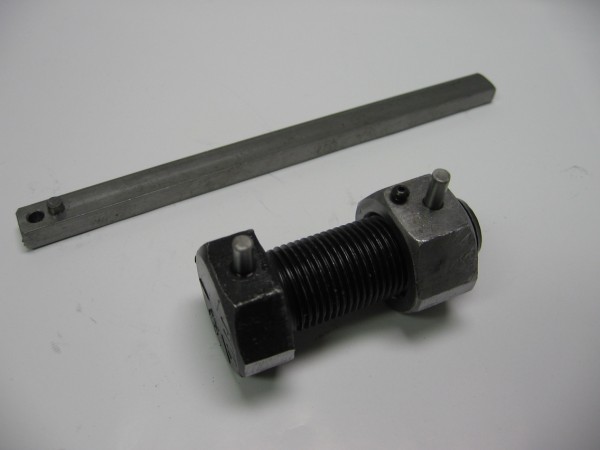

They can be made with a simple bending tool. This one is for 1/16" length adjustments that the expert stunters use with the hard point handles. Easy to make out of a .75"-16tpi bolt

Hey there Rusty. Could you please share a bit more detail about the jig you got there. It looks like a good little project. Thank you.

badbill wrote:So, with hard point handles, how do you adjust the neutral position between one plane and another when you switch?
You use different length line clips to adjust neutral. That's where the jig for bending your own clips in 1/16" increments comes in handy.

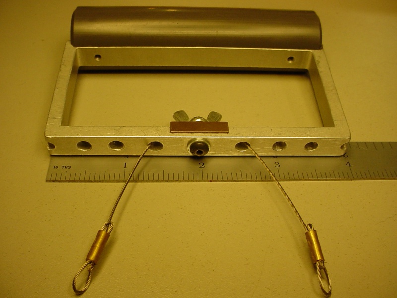

I made some mods to this "Sagan" handle.. and found a cracked crimp-barrel in the process.
My dad had given me the handle a few years ago. I'd never used it.. and wanted a special handle for my CEF Reed Speed model. I drilled and chamfered the frame to add more narrow line-spacing options. The cable-clamp "had" a button-head socket screw for a threaded-hole in the frame.
I installed a longer screw from the outside-in.. and have a wing-nut/lock-washer on there now.
