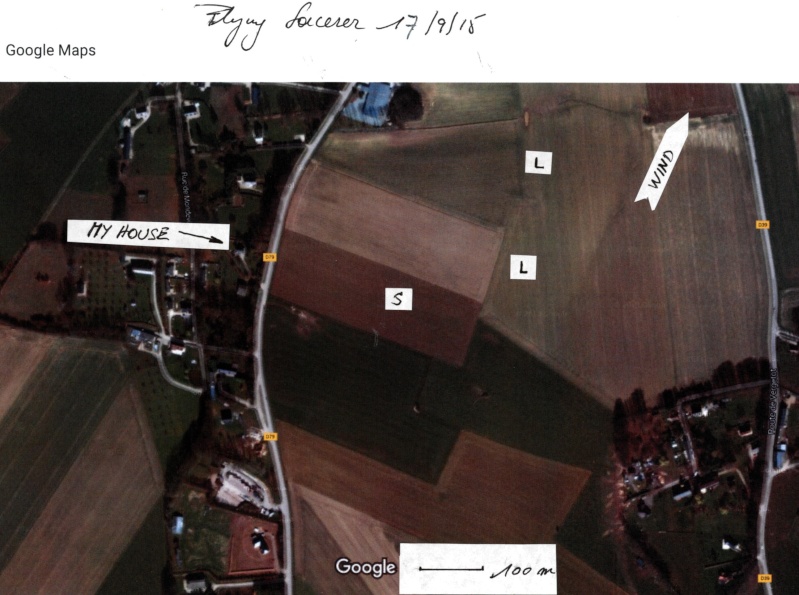

After the first flights on 17 september, I flew the plane again yesterday (2 flights) and today (8 flights).
On 17 september we had a very light south - southwest wind. Most of the time, the plane landed near to the spot it started. Some flights are in the video I posted in the other thread. 2 times, it landed in the potato field; a bit further away
Flying Sorcerer, 3 days' flight report. Imgp3711
Below is a satelite image indicating these 2 landings (marked L).

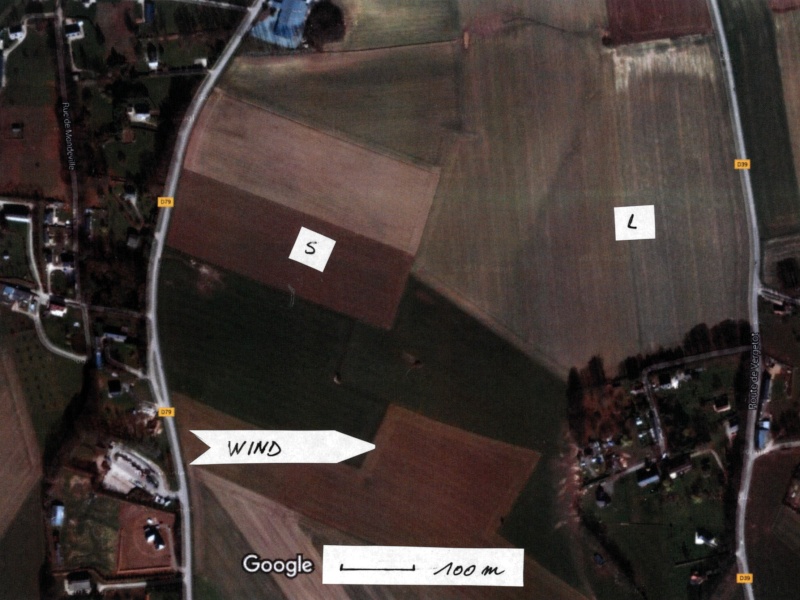

On 19 September, the wind came from the opposite direction and was slightly stronger than the day before. On both occasions, the plane landed in the cow field. Then I understood that free flight is very physical. To collect the plane, I had to walk back to the street and climb over the steel gate to the field. Once you swing your legs over the gate you have to consider a jump back to earth as an electric wire is running behind the gate. After finding the plane, I had to go all the way back. And this X2. After the first flight, I moved my launching point more into the wind without better results though.

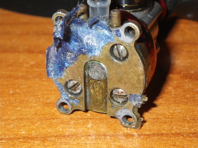

I made some flights today and the Pee Wee can handle the extra weight, but the engine starts to run erratically. I think it needs a clean. I replaced already the silicon tube around the needle but that didn't help much.
Lieven
Posts : 1682
Flying Sorcerer, 3 days' flight report. Empty Re: Flying Sorcerer, 3 days' flight report.
Post  Mark Boesen Thu Sep 24, 2015 10:37 pm
Sometimes when engine speeds up and down it's caused by a little dirt in needle. You might try to open and close needle with a large turn of wrist (appx. 3/4-1 turn) while engine is running, the fuel will sometimes wash it thru. I learned that at the EEA in Oshkosh years ago, where we were using Black Widows with many, many flights and crashes on them and no time for a tear down. You could also remove needle and clean, if not then check airtube/backplate gasket.

Mark, The Babe Bee probably makes up for the weight, but the torque is another factor. The span of the plane is not so big, only 400mm and the engine's torque makes it roll easily. That's why I had to fix the weight on the right side. I don't know what torque a 049 produces but it wont be less than a Pee Wee. I'm thinking of fixing a coin again on the right part of the wing. Maybe not on the edge but next to the tail.
This is how I found the back plate when I took it off. The wire mesh was well filled with goo.
