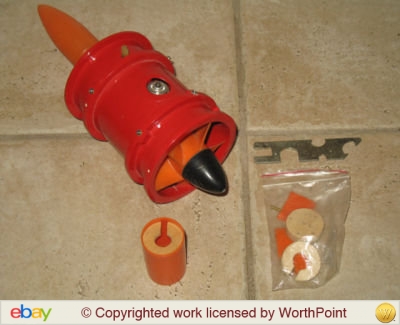

Post  roddie Mon Oct 12, 2015 7:55 pm
Oh.. the wheels are turning! I'm thinking you could cross-slot the bottom of the tube using a miter-saw.. for the axles to fit up into. If it's a tether car, figure out the radius you'll be running.. and angle the slots; so that the axles track into the circle. Secure the axles with legs made from sheet metal strips.. that will follow the body-tube's contour, when screwed-on vertically. The body-tube will support the axle from fore/aft movement.. so the legs need only level the axles, establish their height and hold them captive from dropping out the bottom. You could easily trick this approach out.. by slotting the sheet metal.. where it wraps around the tube.. allowing you to set body-camber and lean the car into the circle.
As for ducted-fans.. you can still find these.. I believe it's a Kress unit. Search Kress Axiflow RK-049.
The CEF "run what you brung" prop rod build Kress_10

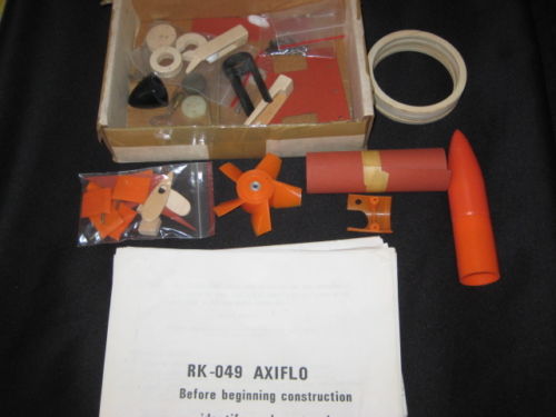

I don't know if that duct-tube comes with this kit shown below.
The CEF "run what you brung" prop rod build Axiflo10
The CEF "run what you brung" prop rod build Axiflo11
The CEF "run what you brung" prop rod build Kress_11
I see the "Midwest" name on this kit.. but I remember when Kress had their ads for this design in the model airplane magazines.. years ago. I wanted one.

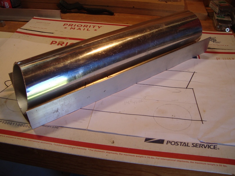

Post  crankbndr Tue Oct 13, 2015 8:41 am
Thanks Roddie, I got one for ya. I need to get symmetrical lines length ways on the tube every 90 degrees for top, bottom and the sides.
If the first line has any twist in it all the others will be off. Huh...

Post  pkrankow Tue Oct 13, 2015 9:16 am
crankbndr wrote:Thanks Roddie, I got one for ya. I need to get symmetrical lines length ways on the tube every 90 degrees for top, bottom and the sides.
Use a bracket.
