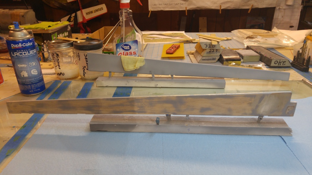

The last piece is made!
I got tired of sanding so I only painted one flap white today, and I'll finish the other one tomorrow. Then I can shoot clear on the flaps and elevators and glue their hinges. All the controls are made up, but they'll wait for the trim colors to be applied just for the sake of convenience.
I painted a test board white before I painted the first flap this afternoon, so I'll practice on that with clear dope in the Preval sprayer and get the hang of it. And also confirm that it really is as compatible as my research indicated. Wayne suggested I thin the Brodak butyrate clear by 60% for the Preval. Now, after dusting on the first two coats of clear, how many more coats should I add? And in the past when I've used Lustrekote clear, I always spray more on the front end where fuel spillage is most likely. How much more should I apply in that area?
Boy I'm tired of sanding. I used 220, 320, and 800. After priming I was worried about how much grain I could see, but after sanding, the DC540 had filled it in like magic. The white is very forgiving paint too. It goes on so thin and covers so well, it can make anyone look like a pro.
Thanks for all of the advice throughout this build. I've been saving my "Thanks" button all this time, and I wish I could use it for more than one of you, but I'll review the whole thread and pick someone to anonomously crown with the rep points. And Greenies will be liberally distributed too. I could not have done as good of a job without the huge amount of input from everyone who's posted in this thread.
The front flap in the picture is now in the cool dry house with the white paint curing.

Brodak dope is not very fuel proof. In fact it's not very fuel resistant. It will stand up to a degree. Raw fuel on it, absolutely not. It can discolor and once it becomes soft and sticky it will wipe off when cleaning with a towel. . This is why I suggested 2 part auto urethane on the nose. If you have Sig Lite Coat on hand, it's the most fuel proof dope available and it will spray over Brodak. John however came out with his Crystal Clear which supposedly is similar to the Sig Lite Coat. It's really clear compared to the BP - 1085. If you note my plane is looking rather greenish. This is due to the yellow of the traditional clear. Cyrstal Clear prevents this.
This is two years of use using 10 percent. This is the result of raw fuel. Note underneath the fuse where my hands grab, it's all wiped off. No biggie, it could've been repaired, but I will continue flying it until the wings fall off.
Your best defense against this is to build up coats on the nose and wax the nose using a quality automotive wax prior to fueling. I have gone to the auto urethane and since disregarded wax.
- Posts : 5322
Re: My Fancherized Twister build; 3 days til Huntersville
Wow that lack of fuel protection is disappointing, I would not have bought it if I'd known that.
I will look into the automotive urethane, there are plenty of body shops around. I have a new can of clear Lustrekote on the shelf too, so I might spray some of it on the test board after the Brodak clear and see what happens. That L.kote is very fuel resistant, but gets crackles in it with age and abuse. I don't have a clue what's in it. I also have clear Minwax poly-u in the silver can that supposedly doesn't yellow. It's as fuel proof as anything I've ever used but I've never put it on top of paint. Nor do I know what would happen if I mixed it with Brodak thinner. That could be a screw up waiting to happen.
I sanded the primer on one side of the other flap today and got tired of sweating. The flap I painted white Saturday and the elevators are beautiful, looks like they were made in a factory. Do you think a couple of days is long enough to safely try the Brodak dope? My plan is to mix it to 60% thinner.
Thanks for hanging in there with me.

Rusty, I mention this quite frequently that no dope is fuel proof. Some are better and some are obviously worse.Sig has the highest resistance. Your 60/40 mix is typical. You can't spray it unless it's thinned to that ratio. I would just keep building up coats in the areas of contact and wax it as I mentioned. Don't allow fuel to spill on it. If you do, wipe it off immediately. I was getting siphoning off of the top tube which was running down the back of the tank. If you have the Lusterkote and you have had good success using it, spray the tank area and nose on the engine side and use the clear for the remainder. I wouldn't use polyurethane, it's oil based and your other paints are lacquer based. If you have to do a repair, this can cause problems not to mention it will make your white look beige somewhat.

That's a good idea. I did learn in my research that many people have used Lustrekote over DC Lacquer with very good results John Tate and Bill Little both have endorsed it for that specific use. I may very well take that route on the front end.Ken Cook wrote:...If you have the Lusterkote and you have had good success using it, spray the tank area and nose on the engine side and use the clear for the remainder...

I've been using Klass Kote two part epoxy paint lately, and I'm very impressed with this stuff. It cures as hard as a hammer, and back when I was using fuel I never had any problems with fuel proofness.
They offer a clear, I have some, but haven't had an occasion to try it yet. I suspect it would provide a bullet proof layer of protection, but I have no idea if it would yellow over time. Perhaps someone else has tried it?
My finishes are nowhere near award winning, but Klass Kote makes my work look better.

Glad you joined us here at CEF. I have read plenty about Klass Kote, never used it, but since I'm expanding my horizons I may consider it. weather permitting I want to start painting the bulk of the Twister tonight, but it's iffy with storms in the area.
For a small forum, we have a surprising amount of talent here. I'd be handicapped without these folks, and they're easier to discuss things with than on some other forums. More of a fun-or-bust outlook here.

Welcome to the Forum JMynes ,, There is another guy on here doing preserves on plastic and using the Klass Kote ithink , it was Expoxy based and I looked into it and had a lot of $$$ in front of it but in the long run would probably bee worth it . Coming along nicely Rusty !! Eric

Thanks Eric. I stood there before supper this evening, looking at it, and and couldn't muster the nerve to pull the spray trigger. Maybe I should wait till in the morning.
