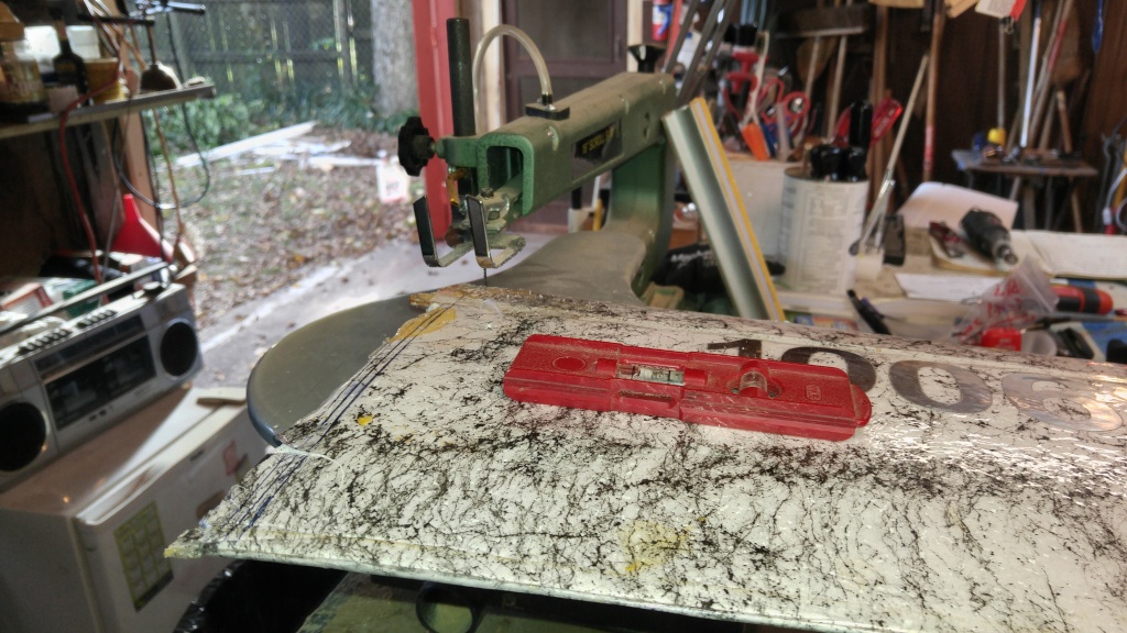

Okay, time to fix this thing. Today I cleaned up the wing root with the dremel.
Then I used the spars as a reference for a 90 degree angle. The whole wing is tapered in every direction, so that's the only way I could get an accurate line. I taped a level to it and made sure my scroll saw's table was level too. I had to watch the bubble and the line and take it slowly, but I think I got a good straight cut.
First I need to glue a block of styrofoam to the end to bring it back to its original length, and shape it to match. Unless otherwise advised I'll use white Elmers glue for that. Then I have to bore holes for dowels. I don't know if there is any real reason for them to extend into the other wing or not, but I'll sink them at least 14" into the repaired wing. Of course they'll be sunk all the way into the 1/2" pine fuselage. Epoxy will be used for this.

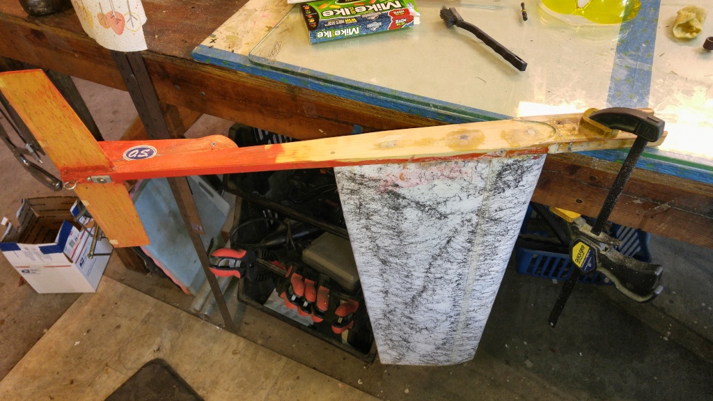

Hmmm...it would seem that the 'Building Mojo' has returned...or is at least peeking around the corner !
Posts : 8401
Re: My Ukey repair!
It has! I put 2hrs and 45 minutes on the Twister last night too. My glass isn't even close to big enough for the whole wing, so I'll figure that out after I break free from Thanksgiving obligations. My table is 8' if I clear it off, but not even close to flat. That time was mostly spent organizing and cleaning my project area, and then cutting laser-cut ribs from their balsa sheets.Kim wrote:Hmmm...it would seem that the 'Building Mojo' has returned...or is at least peeking around the corner !
After I wrote about the Ukey, Wayne called and said he was going to get me a new pair of wing cores from the shadowy Ukey guy who apparently still operates in obscurity doing very little business... because nobody knows he still makes the kits. So I'll wait and see if that really happens. Meanwhile he has another one i can use till the wings come.
