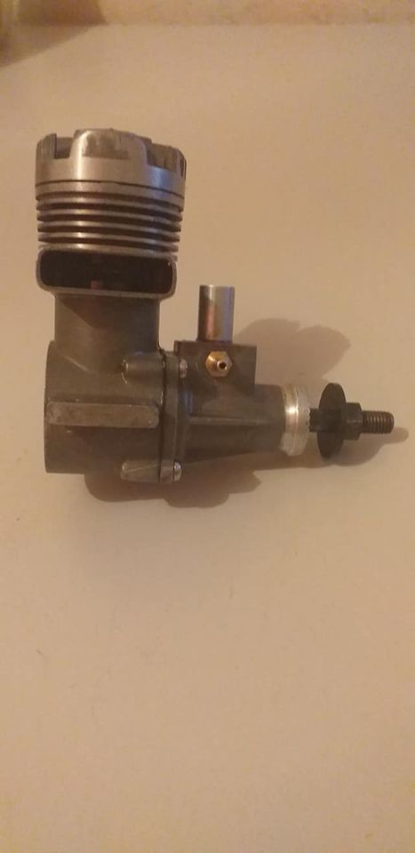

My favorite though is this beast. The 5103 Enya 29 Racing Special (or Speedie as it was sometimes known). This one is destined for a Classic Class B Speed model.
I use Enya 29s (5103 model) in control line Classic Class B Team Race. The 29-III & IIIB were Enya's purpose built team race engines.

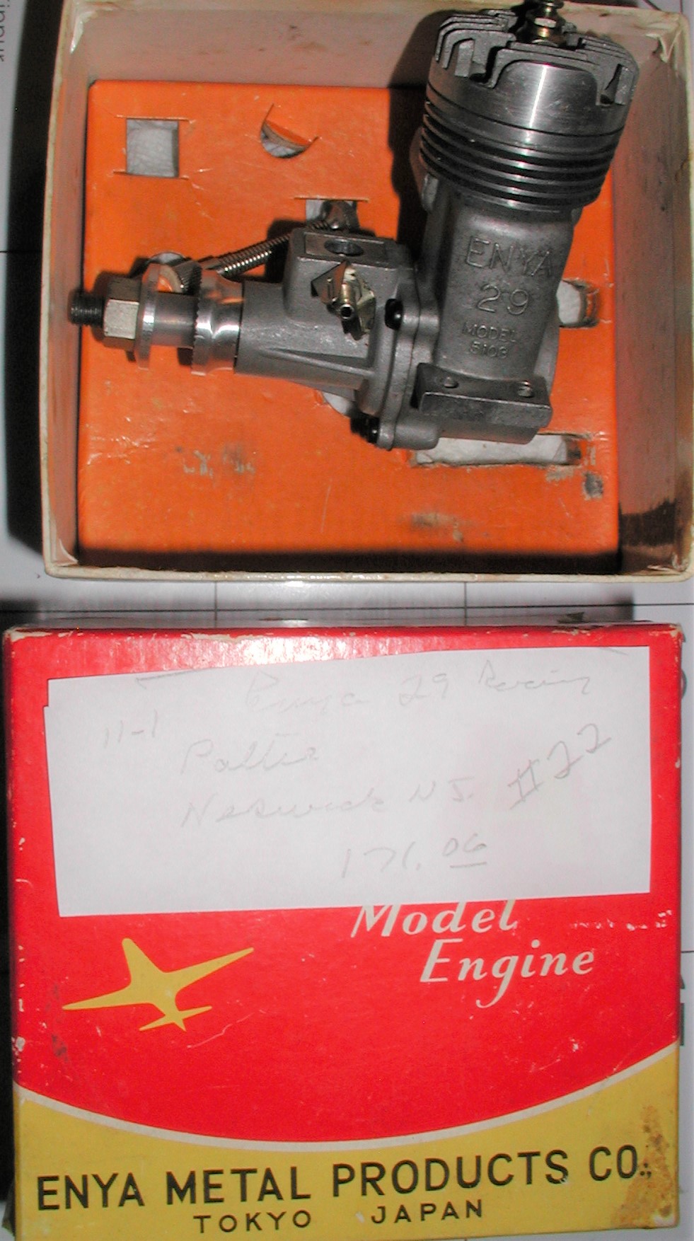

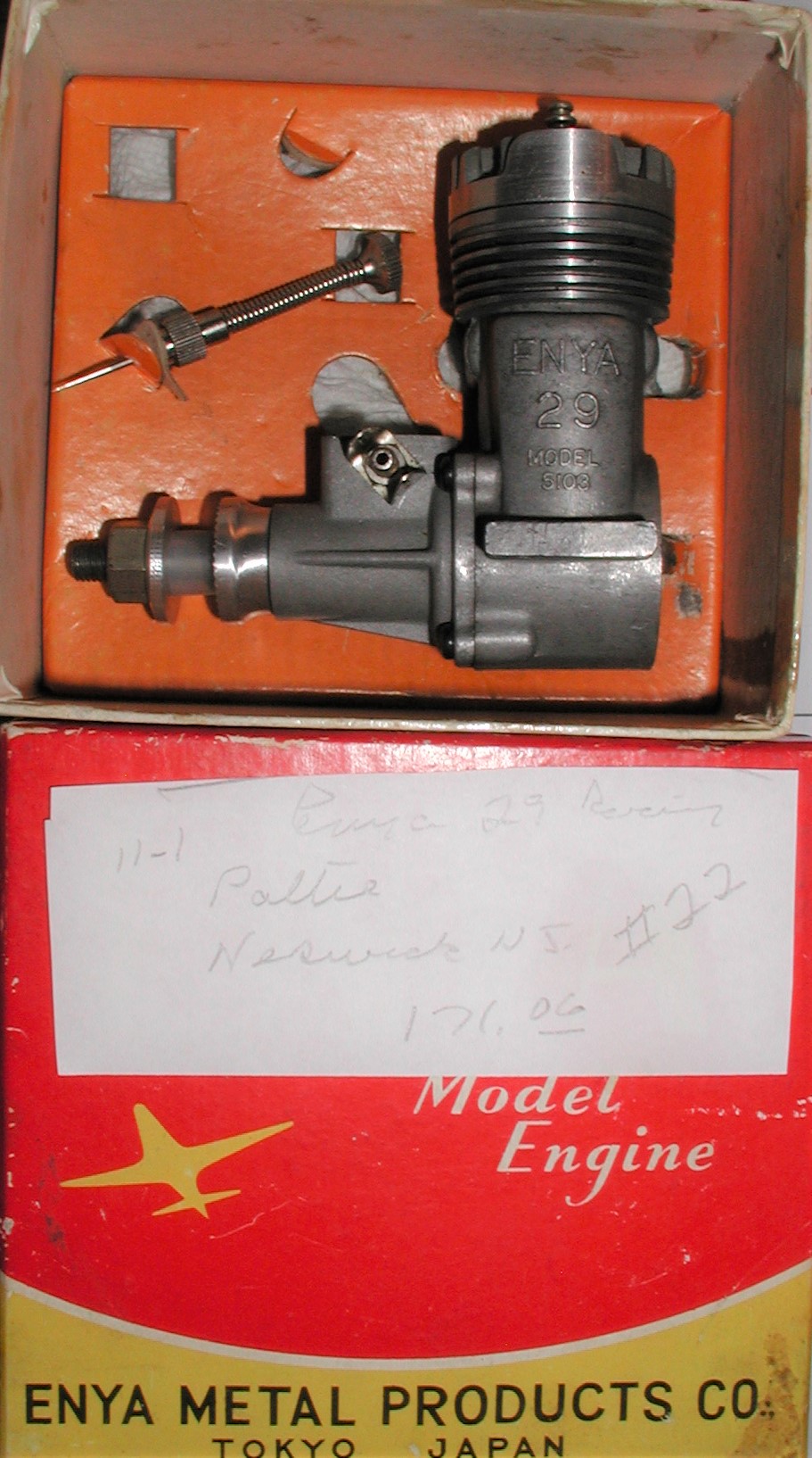

This was shaking me up. I knew I had a 5103 but couldn't find it. Wasn't in my display case and the motor in my Timex Enya tree has gone South, but from what I could see it wasn't there either.
So I started opening up boxes. Love the .29 and this is #22 including sandcasts. My usual price range is/was $5.50 to about $35, but I popped for $171.06 on this, the first one I had seen for sale and it's minus the venturi inserts.
Used and I never cleaned it up.

Beautiful, I wish I had a box for mine. But I'm not a collector, I fly all my engines, so a box would just gather dust I guess.
$170 is a great buy rsv1cox, I stopped watching the last one I saw on ebay (10 yrs ago) when it went past $500US....
@ Getback, WHAT DID YOU SAY??!!!!!!

Thanks Matt, not the correct box though, probably for the ever popular 5224 C/L Enya's.
Notice the cutouts for the different venturis. I forget if it came in that box or it was a box that I had on hand. Circa 1964, the number 5224 was the only time Enya assigned the same number to different displacement motors.
