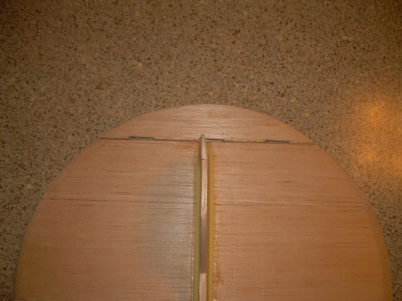

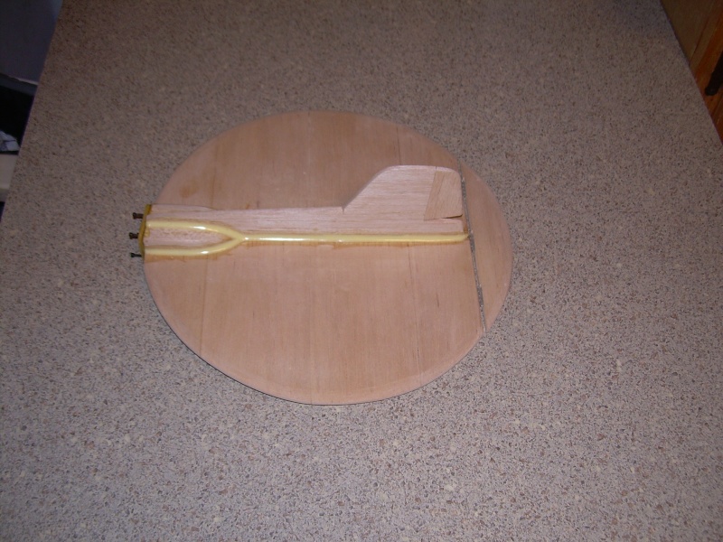

Kim posted a pic of this model some time ago when he was enjoying his Sunday coffee and magazine reading. I happened to notice this particular plane and I was quickly filled with memories of one my dad built for me years ago. Just prior to my sister being born, I recall my father building this plane. I still have the remnants of the original he built but due to paint issues and oil soaking issues I figured it was easier to recut and build another. I showed my dad what I had done and I have to tell you I got the thumbs up as he smiled and said I have to see this take to the air once again. Here's what I have so far. The plans show a Cox QZ but I feel the Golden Bee's that i have will make this one mighty happy.
         A special thanks to Kim!!!!!! This is my newest model the Saucerer Dscn2410
         A special thanks to Kim!!!!!! This is my newest model the Saucerer Dscn2411
It's getting a bit cold to dope, but I will be going forward with it anyhow. Maybe brushing will suffice. This is a unique model and trying to taxi my memory from 40 years ago, I recall this somewhat flying like a Bi-Slob in a hover like mode in a full up situation. I like weird, models like this tend to be the ones that always capture the attention. Thanks again Kim

Doping can be done in the colder temps. In fact I prefer it actually. The humidity is a non issue. The problem is that drying is a issue. You have to regulate drying with different thinners and this can cause some excitability in the dope . What happens is that if your not careful, the solvents now get trapped in the underlying surface longer than it would on a hot day and the paint can blister the underlying coats. The end result is it blisters all the way down to bare wood lifting the silkspan attachment coat. Key is not to spray too heavy and be very careful when masking. I cut my tape and stick it on my shirt so that the tape gets lint on it prior to pressing it onto the model. Once in place, I quickly brush a coat of clear on the tape and proceed with spraying. The tape which now has it's tackiness somewhat dulled down comes off without taking the dope with it. A hair dryer over the tape prior to removal also works well. I just finished the Saucerer today as a matter of fact. It was a rainy day and I worked on several models.
         A special thanks to Kim!!!!!! This is my newest model the Saucerer Dscn2417
I have 3 coats of nitrate clear followed with 2 coats of Nelson urethane. This is the last of my Nelson paint. The Nelson paints are very translucent and generally require 2 additional coats to what I already have on . Elevator needs to have hinges glued in and controls put on. I'm looking forward to flying it. I last saw this plane fly 40 years ago.

Cool looking saucer Ken
What did you use for the fillets in the first photos?
Very clean job there... I like the color scheme a lot also
Posts : 3997
         A special thanks to Kim!!!!!! This is my newest model the Saucerer Empty Re: A special thanks to Kim!!!!!! This is my newest model the Saucerer
Post  getback Mon Jan 11, 2016 11:23 am
Looks really GOOD !! I see you put your controls on the top , that's a good idea to keep them from dragging and maybe better workability too ? Would like to see the maiden if you can Ken . Eric
Posts : 9836
Post  Ken Cook Mon Jan 11, 2016 11:58 am
Fred, fillets are micro balloons and 30 min epoxy. I mix small batches at a time. The beauty of this is that you can go right back on it and it blends in nicely if you run out. If a step is created, I heat it with a heat gun until it levels. I wait a few days before painting them. I just wrap sandpaper around a 3/8" dowel and scuff them prior to painting. Water based urethane sticks to it exceptionally well. Ken

Post  fredvon4 Mon Jan 11, 2016 12:21 pm
That is too funny ken
Years ago you suggested micro balloons and epoxy and caused me to buy a tub of them from Sig..(enough for a lifetime)
Because of the color (mine are more white) I though you used a new or different method
In fact it was your suggestion to use a broken prop cut to scallop profile for shaping the fillets and I have several with different radii I use
Posts : 3997
Post  Ken Cook Mon Jan 11, 2016 12:35 pm
Fred, this last batch of epoxy I bought yellowed as it aged. I go through epoxy quite fast and I didn't have it long, but the air space in the bottle made the hardener yellow. I too use the Sig micro balloons which is what is on that plane. I got pretty handy with the micro balloons and I can keep the radius pretty consistent aside from the spill over which easily wipes off with a paper towel. You would be surprised as to how much weight using it can generate. Ken
Posts : 5325
Post  fredvon4 Mon Jan 11, 2016 1:13 pm
Epoxy yellowing....ah ha!
yep once you said mico balloons and epoxy I fully got it about the color diff
They are so well done in the first photos I thought you might have actually used leather or a caulk gun/two part mixing tube product
in fact they look (at first glance) as raised (convex) fillets instead of coves (concave)
I look at fillets as structural in some areas (stab/rudder) and just cosmetic in others (engine nacelles and wing root)
