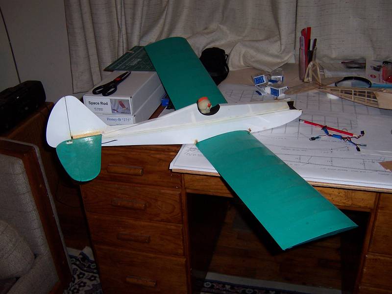

I have a Cox Mantis radio control ARF that has been sitting around in the box for quite some time.  I started to take it apart to get it ready to fly.  I was wondering if anyone knows anything about this little bird.  It looks like it could be a nice enough little plane but I don't know how far I should strip it down just to make sure it is safe.  Any help would be greatly appreciated.

the engine area had been factory fuel proofed and there was a deck behind the firewall.  The balloon tank sat on the deck.  I removed the deck to make room for a plastic tank.

The engine. It started as a tee dee .049. It got a non-spi sure start cylinder, a radial mount, an aluminum carb body, a carb, a starter spring, and a merlin style clamp on head with a hot insert

I re-glued all joints with CA

I roughed up the firewall and epoxied a 1/4" ply mount for the engine mounting and spacing since I am using a radial mount

I put a little extra support behind the fire wall

The fuel tank area and engine area have been fuel proofed with thinned epoxy

Can I just ask, why have you chosen to use a Sure Start cylinder on a Tee Dee. Do you plan to use a muffler?

I chose the sure start cyliner to avoid SPI for all the normal reasons. I probably won't ever use a muffler but I have found that throttle response, especially transition to full throttle after a prolonged idle, is much better and more reliable without a muffler.
