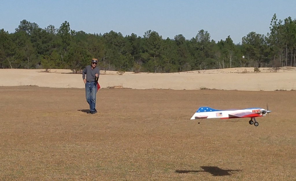

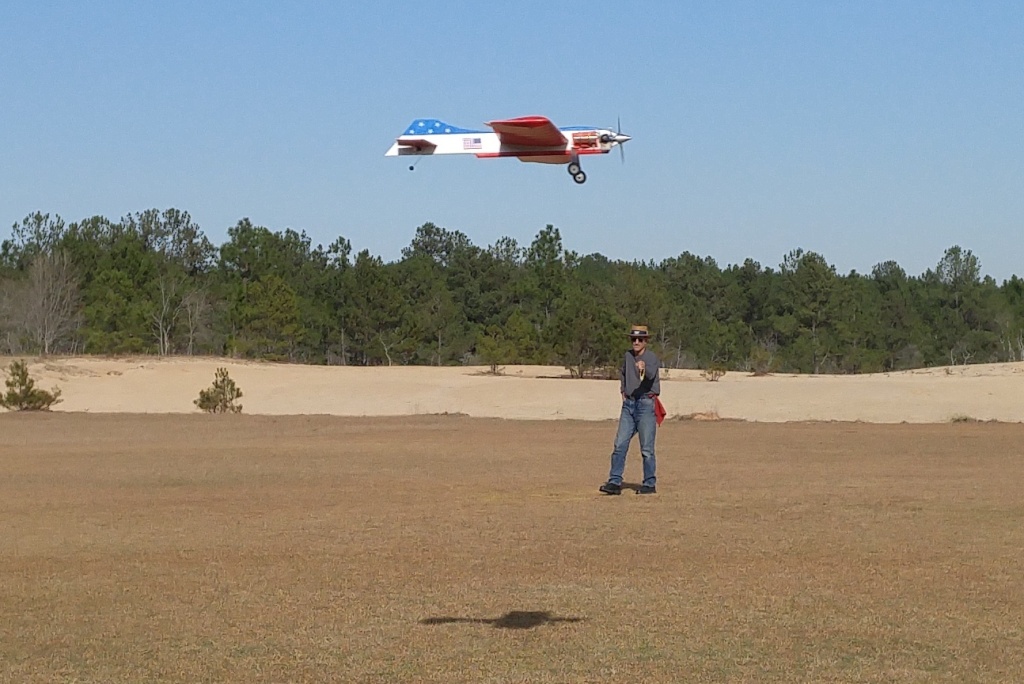

I finally figured out how to get these action shots with my phone:
