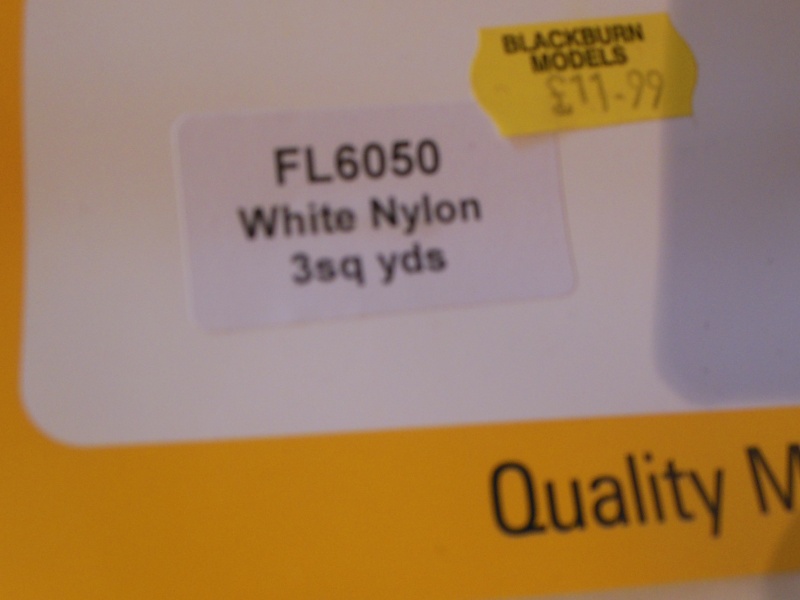

We use nylon quite a lot here but I can only find one weight. It is distributed widely by Flair Models
It is available in White, White and White. Nylon is not easy to dye.
