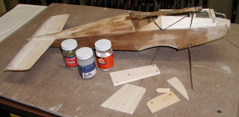

I have used it right out of the bottle, but it goes on to thick for my liking. 50/50 seems to penetrate better but doesn't fill as well. I'm ready to start finishing the add-on's for this Aircrate and will experiment with some 75/25 mixes. No way is it going to come out pretty, but I'm flying it warts and all. Smile
Thinning aero gloss sanding sealer? Dope_010
I have an old bottle of clear and will try a corn starch mix too. At eight bucks a bottle it's not cheap, but it's the only finish I have known, although I have used some of Brodaks color dopes.
This will be two coats sanding sealer (maybe 3) a coat of Lustrkote spray primer followed by a couple of coats of white.

Hey Bob, I'm sure that the old girl will look great with a little TLC and a new coat of paint on her!
