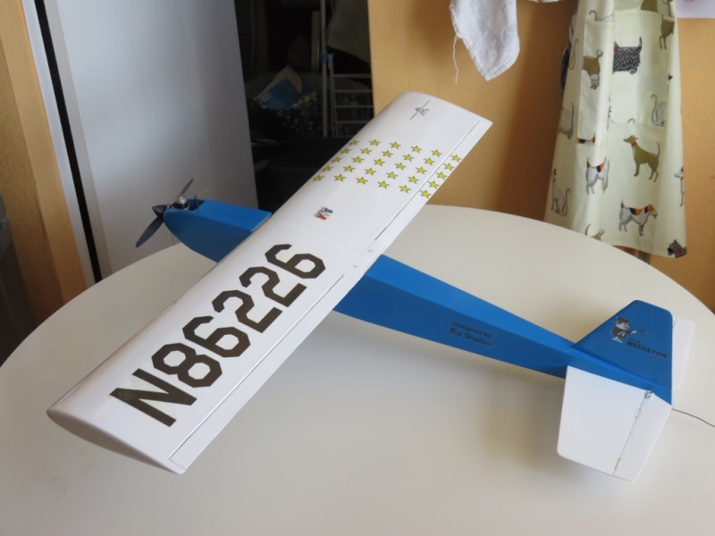

Post  Paul_BB Wed Mar 09, 2016 7:11 am
Here is the Little Mediator designed in 1977 by Bob Wallace:
Little Mediator designed by Bob Wallace Little12
Little Mediator designed by Bob Wallace Little13
The engine is the Golden Bee Mk2. Flies well but needs definitely more power!

Nice looking plane! Welcome to the forum!

Great looking plane!

That's a really nice plane Paul. I can't tell if it's a foam wing or built up. It looks like the center joint is glassed like a foam wing, but I think I can see rib lines thru the covering on the right wing.
Also, tell me about the GB Mk II. I haven't heard that designation before for a Golden Bee. Throttled?

That is a nice clean looking design is it me or is there no rudder ?, I don't see a break in the stab/rudder (just aerlions ) Looks maybe muffler throttled ? Welcome back Paul ! RC Plane

Its a built up wing, no rudder looks like a 6x3 cox prop.
Paul you can run without the muffler for a tad more power.
A Master Airscrew 5.5x4 might get it moving a bit faster
for more solid control. Can also try a high compression
head with 1 shim. What is your nitro content?.

Post  Paul_BB Thu Mar 10, 2016 12:20 am
Thanks guys for the kind words. Smile
I found the plan here :
http://pulling-gz.blogspot.fr/2012/08/rc-modeller-plan-and-article-series_8803.html?view=timeslide
I'm 52 so I was a teen during the 1/2A craze. This is pure nostalgia. I was raised in a hive full of Babe Bees. Next model will be Carl Goldberg's Jr Falcon with throttle.
The Little Mediator has a built up wing, there is no throttle nor rudder. The Golden Bee is a nice engine but the model was designed around the .049/.051 Tee Dee. I want to keep the muffler to protect the engine compartment from the exhaust gases. But I may drill the muffler a little to increase the exhaust diameter.
I bought the Golden Bee Mk II here at Cox International. I suppose they call it this way because it is made of original parts excepted for the plastic backplate?
TDs aren't available anymore so I think I'll buy a Venom II or a Purple Python and put the Golden Bee Mk II into the Jr Falcon.
The Little Mediator flies exactly like a little Ugly Stick. Easy to fly but highly manoeuvrable, no tendency to tip stall, landing speed is very slow.
It is a Cox 6x3. Thanks for the tip, I will try other propellers.

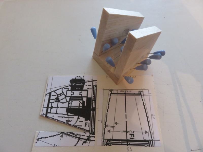

Post  Paul_BB Sat Mar 12, 2016 9:42 am
In fact it wasn't a whole block of balsa. This is how I made the cowl:
Little Mediator designed by Bob Wallace Little16
Little Mediator designed by Bob Wallace Little15

Post  KariFS Sat Mar 12, 2016 9:53 am
Thanks for the in progress photos. I see you used the engine while positioning the plywood ring, good way to get it positioned perfectly. Can you get to the engine mounting screws through the hole in the nose?
I read parts of the build thread in the other forum, very meticulous build. Once I learn to fly something faster than my Slow Stick, this design may well come to my build list.

Post  Paul_BB Sat Mar 12, 2016 10:15 am
KariFS wrote:Thanks for the in progress photos. I see you used the engine while positioning the plywood ring, good way to get it positioned perfectly. Can you get to the engine mounting screws through the hole in the nose?
Yes there is just enough space between the engine and the ring to insert an Allen wrench. I keep the wrench against the engine so as not to scratch the ring. I also need to remove the cylinder/glow head in order to mount the engine on the plane.
The model is relatively easy to fly, especially at low speed. You only need intermediate skills to fly it (it was designed so). No tip stalling, easy to land because of the thick airfoil.
