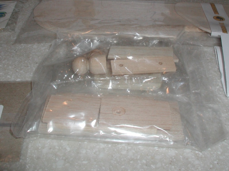

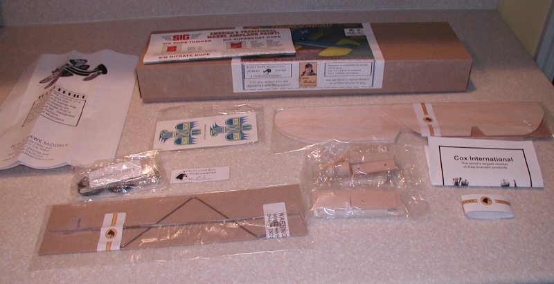

Re: Musciano Thunderbird
Alright already, I just needed a little encouragement.
Nicely outfitted as usual for these BHM kits. But no formed cowl as expected, although a cowl is listed on the parts list along with cowl top, bottom etc.. I think the cowl as intended is just a box. (see pictures) But what makes Larry's model special is the cowl along with his attention to detail.
If/when I build it I will make every effort to duplicate Larry's build. Makes the plane.
