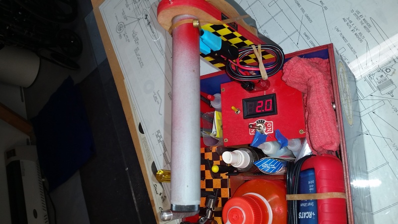

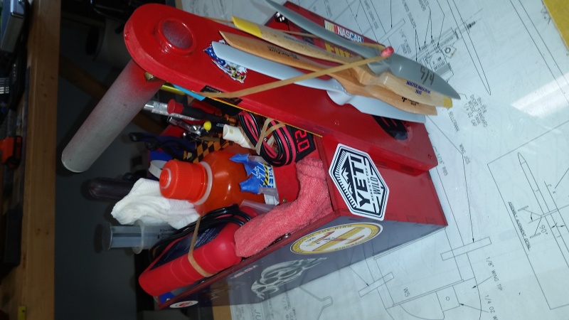

When I built my combat field box (now re-purposed to flight testing) I decided to use two of the Cyclon 2VDC lead acid primary cells
The panel has a volt meter telling me battery voltage NOT output VDC...in use the batteries each can run a long while before sagging under 1.5VDC (my switch battery point)
The Meter requires a 6~9VDC source to run the display, hence the 9VDC bat
The set up needs to have the 2VDC dropped a bit to NOT blow 1.5VDC plugs-- so I have a 5 watt .010 Ohm resister and heat sink (the blue item in center)..this gives me about 1.65 VDC out from the 2 VDC input
As one bat depletes I can switch in the other via a two pole double throw switch
The cells were rather inexpensive from Abat, the meter off e-bay for next to nothing, the resister and switch from a Radio Shack that still has limited qty of these things
These are all the things I pack;
Note the very good RCATs glow driver .... nothing more disappointing then a day of flying planed and some glow drive problem...there are a few other redundant items... I find small hex ball drivers frequently suck so have a spare of each
Hard to see so a list:
Nagalene 500ML fuel jug
Sig Priming squirt bottle
Two 2 oz syringes, paper towels and cloth rag
4 props, chicken stick and finger guard
Handle and two sets of lines
Ear plugs
Thick/thin CA---accelerator
Surgical handle/blade
Prop drive/washer/nuts
Fuel line with two plugs and new section of line
line clips, lead weights
Glow plugs
wrenches, screw drivers, hex drives, pliers/side cutter, and the 4 way
The box has strong magnets strategically placed.
This is glow panel with left bat showing 2VDC charge

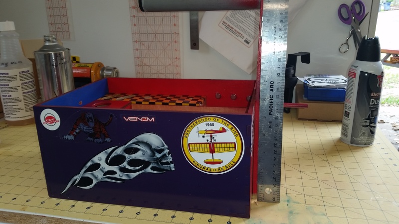

A few other views of the 12" long x 8.5" wide x 6" deep box

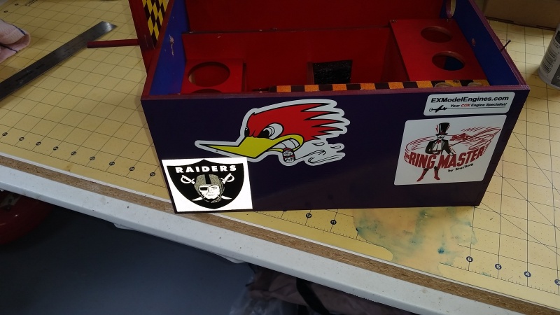

Re: Show Off Your Field Box
Nice fieldbox there. I really like the handle and how its mounted. Thanks for sharing.
- Posts : 3860
That is one Nice ass box , I love the stickers/decals I take it you were a Phantom Warrior ? I need to make or purchase a 1/2A starter some time so I don't have to stay on the ground no longer than I have too , even though its not good for the engine

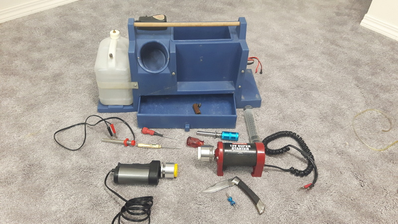

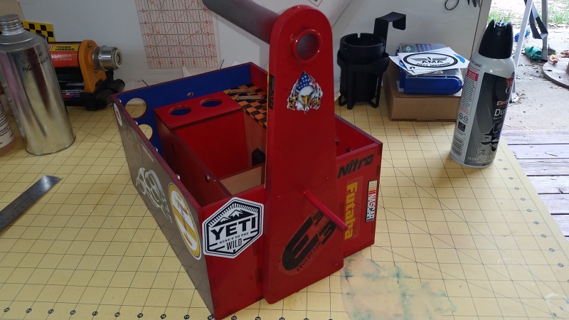

Wow. 1 year later and I now have 3 field boxes.... I had wanted just one originally for playing around in the garage running my engines. So I bought the first one. Then I saw how handy it was so I built a cheap little one for my 1/2a stuff to fly with at the cottage. OK. Build an airboat, ok 2, a .40 and a .049. Well, I need the big fieldbox with the airboat, so it goes with me and the boat. See #3 on our local for sale ads very cheap, so I call and go pick it up immediately. So now I have a 1/2a one for the lake, big one for the lake, and a big one for home too... When do you draw the line?

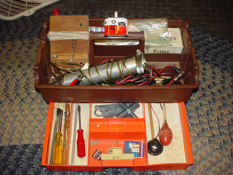

Awesome Chancey!!! You're well-equipped brother! I need to get something together. My old tote would do.. but I need to go through it. It's a cool little tote actually. Very compact for 1/2A C/L flight activity. I bought it almost 30 years ago.. and have never seen another one quite like it.
It's just a "tote".. not intended for our hobby.. but it has a handy drawer that latches.. and slides-out from the bottom. I used it exclusively when I flew at home many many years ago. It held enough gear to keep me flying my little models for hours.. without having to go and fetch things. I didn't have a power-panel yet. I used a couple of "D" batteries wired in parallel to light the glow-plugs. Cox Super-fuel or Racing-fuel was fed to my reed-valve engines. You can see my home-made electric-starter in there. I used to power it using a 12V battery-charger that was plugged-into an AC outlet on the side of the house! I had a pin-stooge with 25' of line for R.O.G. self-launches. (it's also still there in the tote..) It was so much fun! I want to relive those days.

Nice. Very simple, but most importantly very effective.
