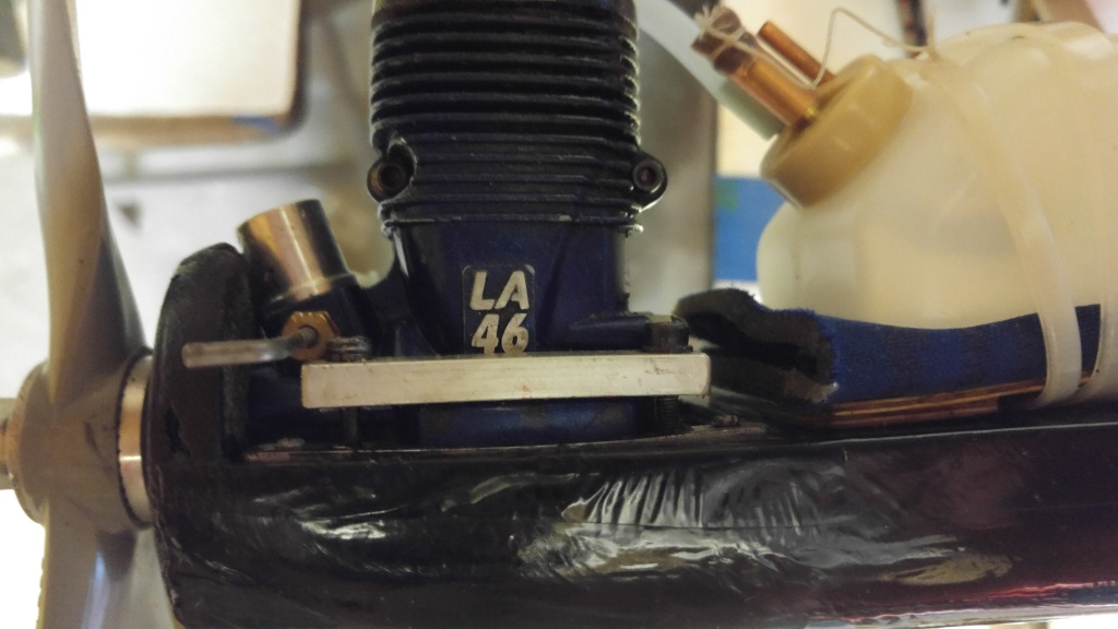

Ken, I remember that advice from you on sacrificial screws, and in fact that's what saved the other three holes. Just bad luck on that one corner though. They were sheet metal screws that bite incredibly firmly into that type of engine mount. The old FP was really doing its thing, breaking 2 and 4 pretty as can be. I just have to shake my head when I think maybe I could have tried harder and maybe caught it. But I have everything I need to build a brand new ARF Nobler. Some time ago, Will gave me a fuse, wing, flaps and Rudder still in the wrap. I'll just miss a good backup plane that I already fly well.
The LA.46 on the Cardinal has a bar mount, and I checked the bolts when you mentioned in your other post that they loosen, but they're all tight. It's a fat .218"(7/32") bar and no sign of bowing...
Whoops, spoke too soon, I ran out to measure and take a pic, and there's a slight bow there, but it hasn't loosened since I checked it a good while back. Not sacrificial though.
