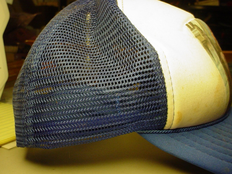

Post  roddie Sun May 22, 2016 6:20 pm
Just throwing this out there Mark.. (you know me..) Do you have any of this style cap/hat hanging around?
It’s Roddie’s Fault Balloo10
One mesh-panel would probably be enough to form a balloon sheath/tube and stitch the seam together with thread. As far as attachment to the nose; maybe use a couple dots of epoxy (frt./rear). The mesh-weave imbedded into the glue-dots should be enough to hold securely with the fueled-balloon inside.

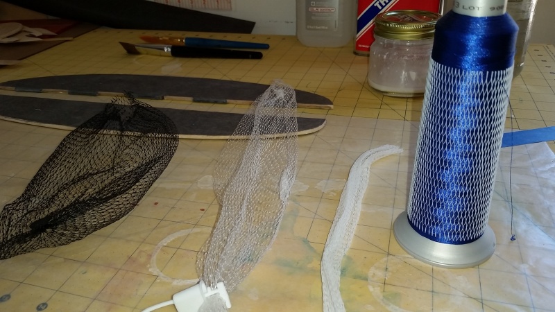

Post  fredvon4 Sun Jun 05, 2016 8:10 pm
Ever since Rusty showed us how he did bladders and the neat side of Fuselage method
I have been finding and saving the various expandable mesh bags some grocery store produce comes in like Tangerines/onions
Yesterday my wife asked me what I was doing  popping all the onions out of the mesh bag and I told her...
She took my hand and walked me out to her Quilting shop and showed me her similar mesh in Yards that she uses over a spool of thread to keep it unraveling
This cheap stuff:
http://www.thethreadexchange.com/miva/merchant.mvc?Screen=CTGY&Store_Code=TTE&Category_Code=Thread_Sock
It’s Roddie’s Fault 20160611
Left...black from tangerines
Middel...white fron some onions
Right... white 6" from a yard of her stuff
Far right...Thread Sock keeping it from unraveling
