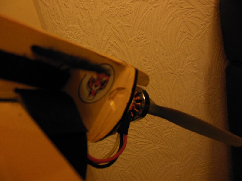

I have a whole host of timers and ESCs of varying complexity. Within the electrickery lies a danger. I have said it before and will say it again - a cheap unconsidered set up is dangerous.
If you crash and can't turn the motor off - if you are lucky the motor will burn out or the ESC. If not there is a good chance of the battery exploding in a ball of flame - no matter what there will be acrid smoke and potentially flames. A stalled propeller will not stop the motor trying to turn it!
So an ESC that recognises a stuck motor and cuts off the power is a must. For me, the timer has to have a configurable startup delay, the ability to adjust the motor speed, set a time for the flight and issue a warning when the time limit is reached. The ESC should also warn of a low battery.

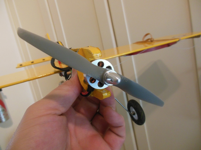

This week I finished the ACE+. It is configurable as a trainer and a mild stunt model. It looked ideal as an introduction to control line for one of advancing years.
Simple and quick to build.

and prepare for stunt mode.
Add more tip weight (per instructions)
Replace prop with a 5.5 x 4.5
I now have to increase line length to 25ft (per instructions).

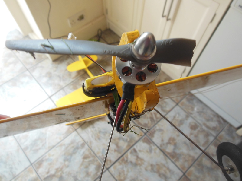

I really haven't a clue what happened - I couldn't see. Must go earlier next time - my shadow seems to tell me that I was doing a wing over but whatever happened, happened in a quarter of the circle.
When I examined the model - the timer was disconnected and I need to look at this further as when I got home - it (or the ESC) doesn't appear to be configured with the motor. Whether this is a result or a cause - I don't know - a trifle annoying but I just need time now to reconfigure.
Damage - almost nothing. The battery put a little dent in the motor mount.
but the battery has a dent in it.
I need to discharge a disable it. It is always one of my worries about electrickery flying. Those batteries are dangerous if damaged.
