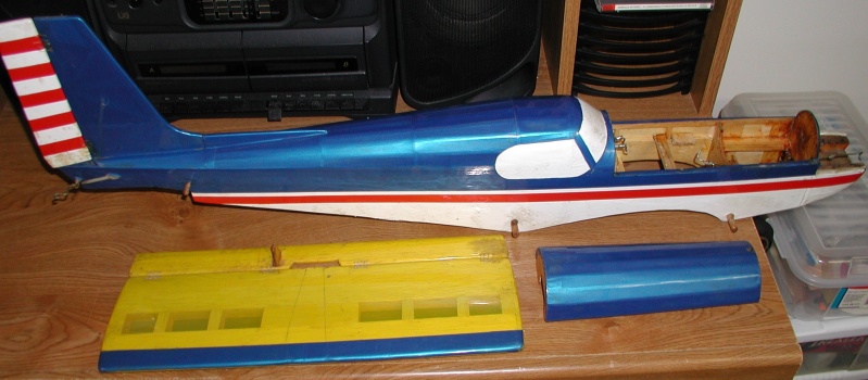

When this arrived carefully packed and without damage:
Lot's of caked on castor that cleaned up well (right side of wing only) with a no scratch pad and Simple Green:

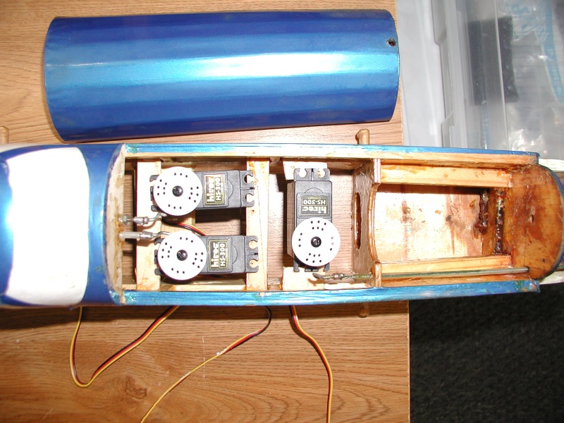

Installing it is going to require new bearers but I'm going to keep the rather weird, non-adjustable and home made connectors as changing them will require a lot of alterations. But I will change out the engine throttle control to a golden rod.

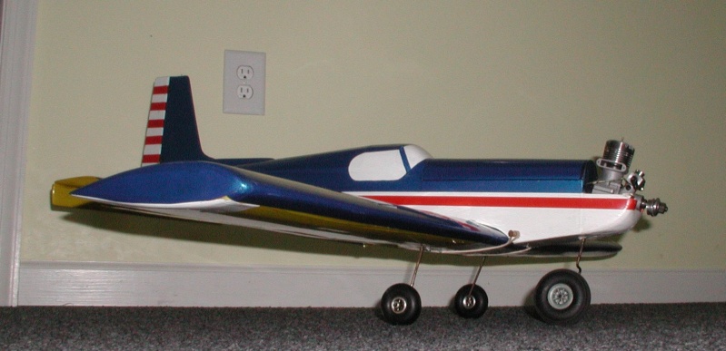

I got the rest of it cleaned up. Even put a coat of automotive wax on it.
The front wheel is pretty much ate up. I replaced it with one the same size, then a larger one. Looks like I'm going to have to replace the strut to increase the AOA or it will never get off the ground as it's way nose low. Also presently the nose wheel is not steerable, but I have a few longer steerable struts that will fit just fine.
I'm reconsidering those connections. I will have to replace them all with adjustable clevises. I'm just not good at guessing fixed neutrals.

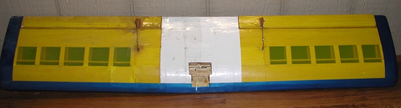

That's an aerobatic wing. Not as blunt as a CL stunter, but should fly upside down as well as upright at about the same trim and throttle settings... yeah, like I'm an RC trimming expert Lol. I am interested though. Maybe I can learn something from you.

Nice looks like its gonna be a rather fast flyer with that fully symmetrical wing and cudo's to Kim for being a cool guy!

One of these Enya's will power the new plane. I found a tank that will fit along with a steerable nose gear. The PO really attached the existing gear, going to bust some balsa to get it out.

I'm going to pull all the control rods after all and use the servo tray that came with the radio to position the controls. Lot's of fun stuff left to do.

The JR battery packs are two wire they were I guess too lazy to mod the leads. The outer most lead (the light brown one) is not even hooked up in the pack. If you already know this forgive me but make sure you do a full range check on the system before installation and after with the antenna collapsed pointing away espeshly since this is an old radio and since those servo's are the old style Hitec gold label versions, I would make sure the grommets and eyelets are installed before mounting. The fixed control system shouldn't be too much of a problem as long as its correct. The radio appears to have ATV pots (Adjustable Travel) you can use them to limit or increase the control throw if needed but if they are not centered ...then that's where you run into the "fixed" problem. With the wing if it is fixed which i'm sure it is from your description, it might be easier to mod the wing for a two servo setup and use a Y harness than modding the existing system. Again If you already know forgive me.
