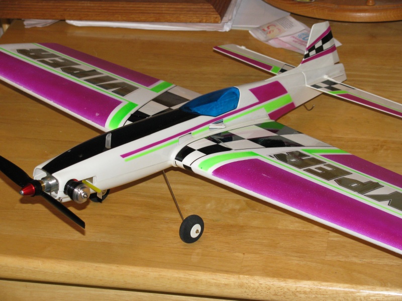

Post  crankbndr Thu May 12, 2016 6:24 pm
I assembled one not long ago and found no issues with the screws, I have had problems trying to use a standard screw in place of the special Cox screws for plastic on other models.
Maybe taping the post first with the Cox screw will help. I never got to fly the Hyper Viper and wound up sending it to a young man Down Under.
Some of these models had problems with the fuel tank, make sure it flows well. Also I had problems with the elevator hanging up because of flashing from the mold but a little sanding fixed that.
I have heard of taping up the bottom fuse where it is open for better performance. Getting the last two engine screws in was a challenge without a magnetic tip driver.

Post  RknRusty Thu May 12, 2016 6:52 pm
That's gotta be the prettiest bird Cox ever made, I've lusted over pictures of them for years. It looks like a full blown stunt ship. If only they'd put a Tee Dee in it... or a Conquest on a pipe Lol.
