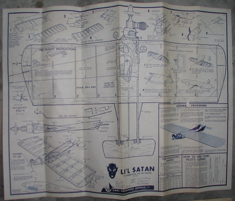

There has been so much discussion here regarding the combat stunt Li' Satan that I put it on my bucket list to own one.
Yesterday my son visited a yard sale and found a bunch of 1/2A partial kits of popular Quillows models that had been built but still retained some parts and all the plans. But one was a Goldberg kit of the Lil Satan that looks mostly complete. Not sure if you can tell by the photo but perhaps you Lil Satan fans could clue me in. Missing parts?
The Sig box contains some olive drab plastic parts of maybe Cox or Wen-Mac planes plus some other stuff including a rather novel tail wheel assembly. All the plans are there for the boxes pictured but not much usable. $12 worth of exploring.

There's very little parts in a Lil Satan. The plan is full size and pretty much shows what's needed. A very easy and overlooked part is the triangular gussets at the wingtip and trailing edge. Without them, the wing is subject to racking. In addition are the tail boom gussets from the trailing edge to the booms. I would like to add though, the center section sheeting should be replaced with wider sheeting. The sheeting can cantilever over both sides of the center ribs to allow a larger base for covering. As is, there's little to no area due to the plane being silkspanned and doped prior to gluing on the booms. With the wider sheeting, you can easily pre assemble allow yourself a little luxury of iron on covering without the risk of it pulling off of the sheeting into the open bay. I typically make it a 1/4" wider.
The integral tanked bee is probably the worst engine possible to use on this model. While it was designed for it, the plans dictate how the pickup is to be placed due to orientation of the backplate. Not only is it next to impossible to assemble as shown, it rarely ever works or stays put. A solution for this is to make a new firewall so that the orientation of the backplate has the needle facing up. Unfortunately, this places the needle in a bad position subjecting it to breaking or bending in a ground strike. I have redesigned many for product backplates and placed a tank directly behind the engine (Not over into the next open bay). The Lil Satan turns just fast enough to provide fuel delivery issues. These issues become quickly noticeable using a Black Widow or Golden Bee.
I would also like to mention the center gusset on the elevator. It's purpose is to provide a bit of stiffness to the elevator and offer a larger footprint for the control horn. The single screw control horn is about useless. While on this topic, the control wire is shown on the print with a kink in it. The wire itself in my opinion is undersized and placing a kink in it and where it's located promotes bending. If possible, try and forego the kink and give the wire the straightest shot possible to the horn. A kink can be made directly after the bellcrank end to allow the wire to exit the sheeting. Seeing that you really can't brace with a fairlead, this keeps the controls from mushing out. The stock horn is too small and the center screw allows it it to pivot which can and will crash the model. The gusset on the elevator is balsa, if using wood glue, it will dry and dial a cup into the elevator. This center gusset piece should be substituted for a piece of 1/64" ply. Finding a decent piece of C grain balsa for the elevator will also discourage this piece from warping. If doping, place equal amounts of dope on both sides of the elevator.

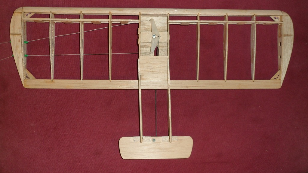

Expanding on Ken's advice, here are some mods I did to my Satan.
I cut a new elevator and hinged it with a CF rod with a 1/16" wire through it. Wired it to the stab so the tube rotates on the wire. Also in the pic is a .5" horn cut down to two holes and connected a clevis to the top hole.
In this next pic, the small CF rod in the background passes through the center sheeting and is JB Welded to the 1/16 wire to the bellcrank, with the clevis in the top pic on the rear end.
I changed the engine to a Tee Dee using the aluminum radial mount.
But if you don't want to use a pressure bladder, a Medallion would work with this mount too. Notice my lead balancing weight screwed to the wings n the crankcase to account for the lighter engine.

Bob, the booms were 1/8" originally. However, the Satan is a touch nose heavy. This is fine for the beginner but for the more experienced, a bit of tail weight is necessary. I found that( 2 ) 1/8" wheel collars balances the Satan when the collars are installed on the pushrod all the way to the rear. Of course all this is irrelevant due to different engines. You can take many different Black Widows and Golden Bees and you'll be amazed at the weight differences. I would think that 1/4" tapered and shaped would more than likely do it well. I would only recommend this though for the experienced. Old style woodie wings can get a bit flighty especially on initial launch. Once the speed comes up it stabilizes but for the first lap it can be a roller coaster ride until it settles in. A nose heavy wing will do far better here. If you noticed, the Satan has no wing tip weight. The engine nacelle is all the way to the right with the cylinder pointed outboard. It does work, but I would still utilize 4-5 grams of weight in the outboard wing. It just keeps things from getting crazy.
While it's not clear on the print, the print mentions of not throwing any scrap pieces of wood away until complete. The leading edge is square at the wingtip ends. Adding small soft blocks and fairing them down to the wing tip assists in the covering aspect. Directly on that corner is where the compound curve is stressing the covering the most due to trying to radius in such a short span. Without these blocks the wrinkles can really compound in that corner so while it may not be necessary to install them, it really does the covering justice and it's one of those little things that just looks attractive when added. The plans suggest a 5 1/4-4 prop. This is the largest prop I would ever suggest using a Black Widow or Golden Bee due to it loading the engine too much. The wing however has a lot less drag but nonetheless in this application a 5x3 would do better in terms of rpm's as these engines tend to like to run on the higher rpm side with repeatable results.
Many like to stay with tradition in regards to covering, but I would never ever recommend silkspan on this model. It will just get torn up due to grass and weeds. It does add strength, but it presents far more problems in a negative way than in a positive one. If you do cover the model in a dope fashion, I would make it a synthetic covering opposed to the silkspan. I'm a fan of the iron on and I have never been faced with a weight penalty due to using it.

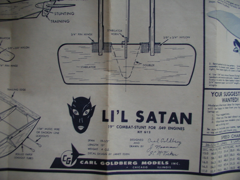

Regarding the need to make the booms; it looks like the elevator is on a higher plane than the wing. Maybe that's an illusion because of the boom-shape? I've seen plenty of models that have a tail-plane that's higher than the main-wing.. but it just seems to me that it would adversely affect the model's ability to turn equally in either direction. I'm wondering too (if this is the case with the Lil' Satan).. whether that adds to its inherent instability when launching?
I'm just asking this question so that when Bob makes his booms.. he puts the hinge-point in the right place.
Re: Lil' Satan and friends
@roddie wrote:Regarding the need to make the booms; it looks like the elevator is on a higher plane than the wing. Maybe that's an illusion because of the boom-shape? I've seen plenty of models that have a tail-plane that's higher than the main-wing.. but it just seems to me that it would adversely affect the model's ability to turn equally in either direction. I'm wondering too (if this is the case with the Lil' Satan).. whether that adds to its inherent instability when launching?
Yes, that's been concerning me also. While it has a "flying tail" type elevator and isn't fixed I still have to position it correctly in relation to the wing and determine the movement limits. I wish the plans showed those booms in profile in full scale.
Shaving and tapering the 1/4" balsa for the booms is a good idea although I may have some 1/8" around here someplace.

One more thing I forgot to mention, not only for flyability, but for better looks also. A spar to hold the shape improves airflow over and under the wing. If I did it today I would have installed it farther back at the high point, but you get the idea. I was still on the upside of my learning curve at the time. Notice I put crude shear webs between the spars too. The spars are CA hardened 1/4" balsa and the webs can be 1/32" vertical grain, and should be wider than mine and face mounted as shown.
This is before I realized I had to widen the sheeting to accommodate iron on covering. That was a quiet scream moment. It also shows the shaped blocks at the corners of the LE that Ken mentioned.
This has been a fine and tough flyer and still is to this day. This pic illustrates the benefit of widening the sheeting for Monokote too.
No guessing required for the tail boom side profile and location of the stabilator height
It is pictured just under the left wing panel on the plan...... just not full sized
Photo copy that area of the plan and then adjust size so the rib profile is the same length as your kit ribs and the tail boom size will be correct
Posts : 3439
Everything about making the booms is on the plan full size. Look closely and you'll see it has a couple of triangular protrusions that act as stops to limit the throw, so you shouldn't have to guess at any part of the boom, hinge. stab assy.@rsv1cox wrote:@roddie wrote:Regarding the need to make the booms; it looks like the elevator is on a higher plane than the wing. Maybe that's an illusion because of the boom-shape? I've seen plenty of models that have a tail-plane that's higher than the main-wing.. but it just seems to me that it would adversely affect the model's ability to turn equally in either direction. I'm wondering too (if this is the case with the Lil' Satan).. whether that adds to its inherent instability when launching?
Oh I see Fred's right, the profile isn't full size. Hmm, I'll investigate my Goldberg plans, I have both.
