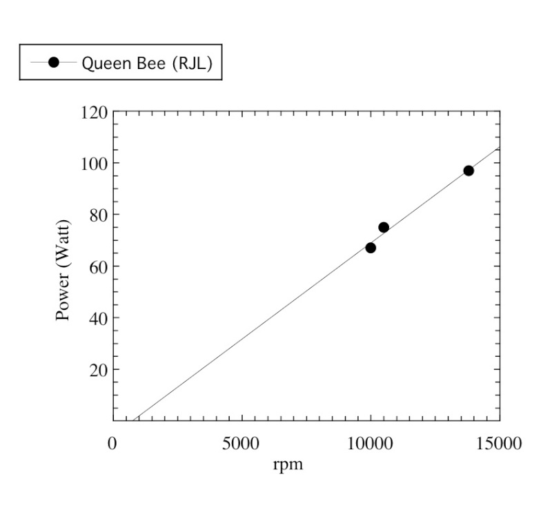

I do NOT know neither the engines RPM to energy graphics nor the dynamo's RPM to output energy graphics as these are not available.
Here are some typical power curves for the Cox .049 engines. A Sure Start on glow fuel is probably close to the Babe Bee, while on diesel there might be a little more torque for any given rpm.

Here are some of my own data for the Queen Bee engine converted to diesel by using an RJL 09 conversion head;
This is very interesting. Thank you for this post.
Cox .049 SureStart Diesel cannot reach the speeds your engine can. The RPM which the engine can reach for sure is 10000. Whether the engine reaches anywhere from 10000 to 13000 depends on the load, fuel and temperature. I will probably never test the engine at such huge RPM or, in case I do, this will be in a very remote future because I am afraid I may damage the engine. I prefer not to reach the maximal power output and not to test what happens thereafter but to keep the engine nice and safe.
Slow burning fuel may not be able to reach high RPM and the power output may be very low at high RPM and reach maximal power at lower RPM. To make the fuel slow burning, I think, one may need to decrease the amount of Ether and increase the amount of Kerosene. Thus, per single combustion at lower RPM, the engine may get more power from the power giving Kerosene, but, at very high RPM, only some portion of Kerosene would burn and, regardless of more combustions per second, the power may decrease significantly because the power of one combustion decreases incredibly significantly.
Again, I just say what I think and not what is. I do not have a way to measure the output and I have only two known loads ( only two propellers ) which may not be the best way to generalise.
A good way to measure the power output of the engine would be a somewhat known loud, for example, a dynamo or an alternator with a known response, which I do not have.
With a dynamo with unknown response, the overall energy of the system can be measured just by multiplying current by voltage but there is no way to know how much energy the dynamo looses in order to say how much the engine gives.
There is nothing huge about 10000-13000rpm for our two-stroke model engines. On the contrary these are very modest revs. Most glow engines for instance will overheat if they are propped with a too high load and forced to stay at or below 15000rpm. Diesel engines are a little different and they can quite happily run at around 10000rpm but not much lower (at full throttle). So at full power from the generator I think the engine will be most happy if it revs at around 10000-13000rpm.
For a given prop and rpm you can calculate the power the engine makes by using an excel sheet from Pe Rivers who worked at MVVS. He has passed away but a similar calculator can still be found here; excel sheet
If your engine makes 10000rpm on a 6x3 prop it is putting out about 16W in order to do so. Props from different makes are all a little different in their load, but this gives you a good estimation. With a nearly constant torque curve, this engine would then make a staggering 8W at 5000rpm.
This is assuming that it is able to run at 5000rpm with full throttle without overheating....
I agree the maximal power will be at higher RPM but I cannot imagine to be at around 10000 RPM which is stated to be very close to the maximal RPM.
Heating at low RPM is a problem which I expect and, hopefully, I would be wrong. I understand the propeller will take power from the engine. Initially, I will run the engine with two propellers : an 8 inch double blade as a back up and a 3.5 inch triple blade as the preferred one. I also have an option to use big blade quadruple fan, around 4 inches diameter.
I have also mentioned the electrical blowers which I am not sure whether would be powerful enough.
By examining the propellers, I think the maximal aeration a propeller can give to an engine is directed towards the engine and slightly to the right ( looked from the pilot seat ). Thus, I think to put the electric blower to the left of the engine, blowing towards the left side of the engine ( looked from the pilot seat ) and the back of the engine too.
To reduce the heat, I will use rich mixture and not very high compression which will reduce the power.
The only reason to try to do whatever I can to avoid running the engine at high RPM is to avoid the wear of the engine. Otherwise, there is no problem and I can always do so.
Running the engine with more powerful diesel ( more Kerosene ) will also increase the temperature.
Also, the adjustment of the engine depends on the application. In some applications, for example to run a USB powered device, the engine needs to provide just 2.5W because, as mentioned, the USB specifications state a USB powered device must not take more than 0.5W at 5V.
This is why I like the freedom of having three adjustments : the mixture, the amount of fuel and air and the compression.
The 8 inch propeller not only consumes energy and room but is very inconvenient to work with. With a 3.5 inch propeller, one can put hands over the propeller to adjust the controls. More blades will consume more power BUT will provide extremely good aeration with no significant consumption of real estate.
I have to run the engine to see.
