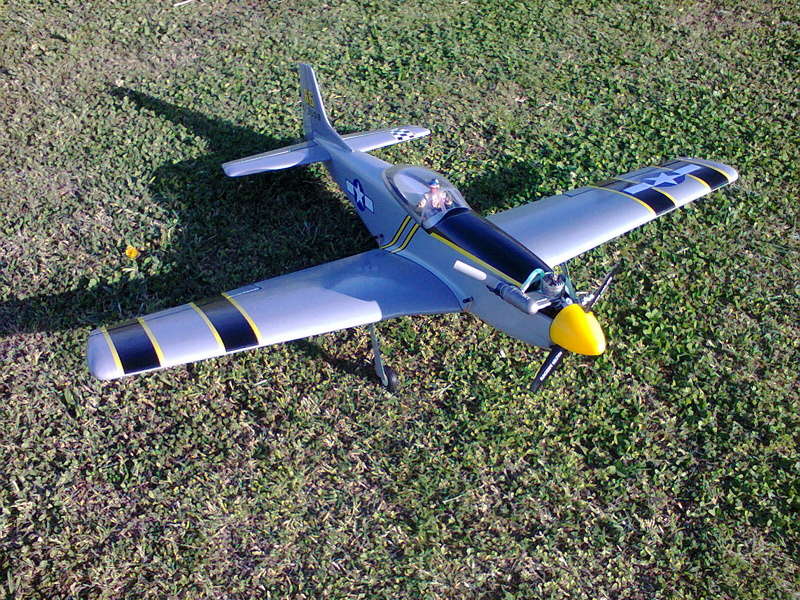

Post  MauricioB Sun Sep 25, 2016 9:53 pm
I began by starting the engine for the first time.
These are the initial parameters:
20% Fuel 80% methanol castor
Propeller: 8x4 Master
P51 Mustang by Kyosho (restoration)and flight video Foto1012
P51 Mustang by Kyosho (restoration)and flight video Foto1013

Post  MauricioB Sun Sep 25, 2016 9:56 pm
You will see that the carburetor is racing full and revolutions are from 5100, this is because the needle is open so that the fuel-rich engine work.
I did the engine to consume 600 cc 200 cc intervals for up.
Has a perfect start and the last tank started to sharpen the needle, marking a 12700 rpm, always with the same fuel without Nitromethano.

Post  MauricioB Wed Jan 25, 2023 10:14 am
The original Kyosho kit provides a mount and adjustable metal plates, for that reason, it is possible to "play" with different motors.
The Enya .09 engine requires the use of metal plates mounted on the nylon bed.
Engines e.g. O.S. .15 r/c, O.S. .15 FP, the MVVS .12 r/c engine, can be placed directly on the nylon bed, since the fit is perfect. in this case the additional metal plates are NOT used.
P51 Mustang by Kyosho (restoration)and flight video Engine11
