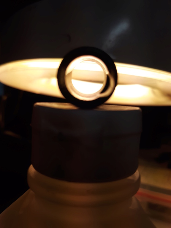

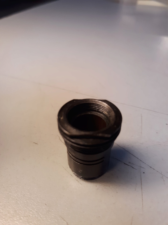

"Ambiguous".. true-that. Photos of a #3 that I have. It "does have a #3 stamp.. tough for me to photograph..)

my #3 appears to be a later (thick-wall) cylinder, which has flats milled for the Cox wrench.. but its OD has not been ground for a sleeve (exhaust-throttle). It has the later dual-slit exhaust-ports.. and doesn't have SPI.

..and is a single-bypass cylinder..
