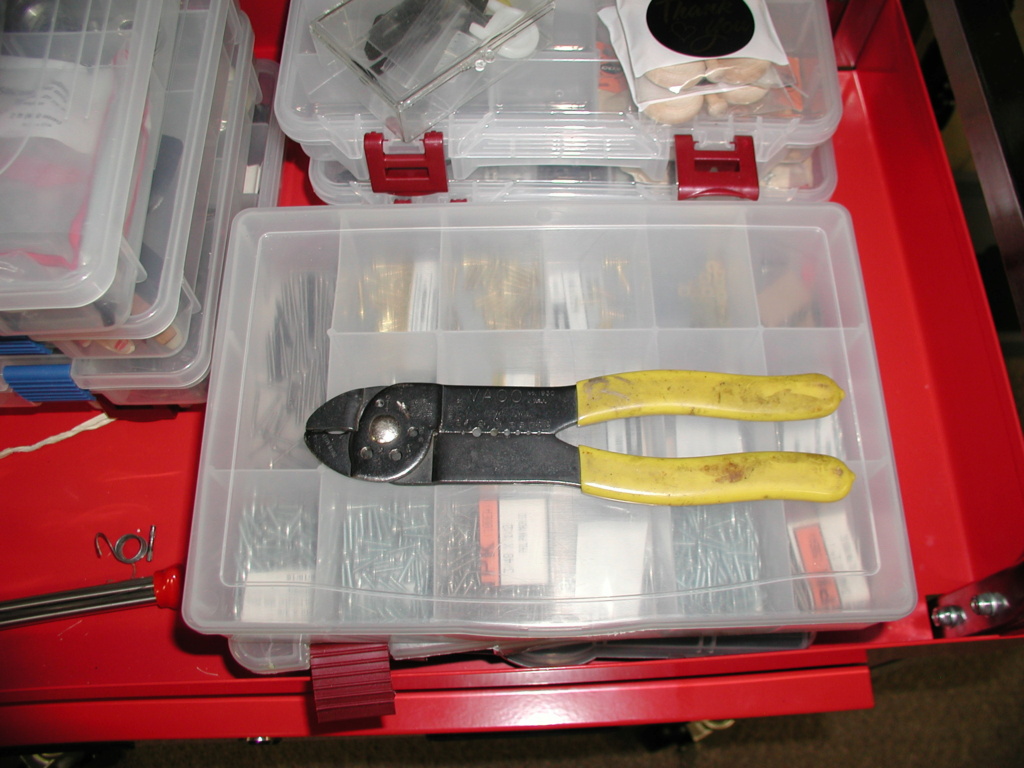

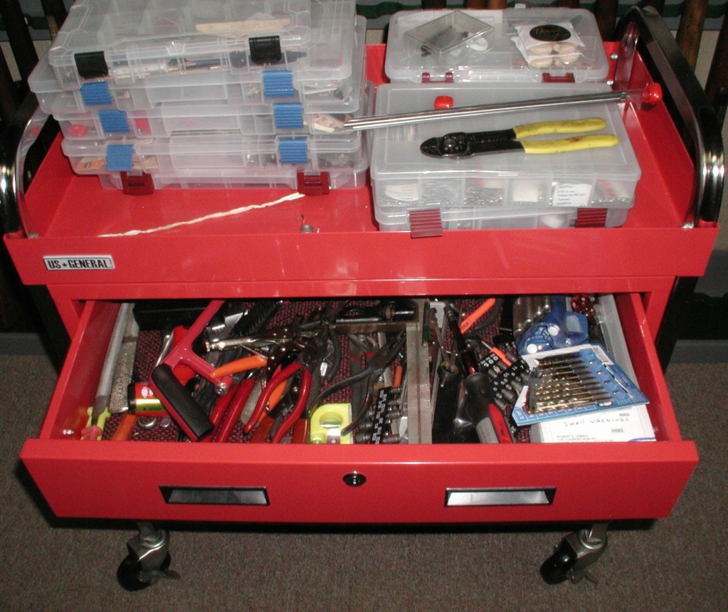

I use this VACO crimping tool to cut 2-56s to length (roddie is a big fan of these). Just use the 4/40 slot. Gives a nice square cut that I dress up on the fine grinding wheel.
I also like the compartmentalized plastic boxes. I used to have everything in small plastic cabinets. This way I take the box with me. Harbor Freight roll-around too. Goes where I go. Just got these 12" long lengths of music wire assortment via ebay. I miss the local hobby shops of yesterday were I could buy individual pieces.
