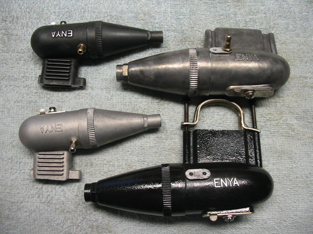

I picked up some Enya mufflers (seven of them) a few months ago at a swap meet.
Got a good deal on them ($5.00 a piece)
All missing the screws/bolts for them.
Two mufflers (Enya 19X) missing the straps and hope either Bob Brooks has them or Ken Enya?
There is other straps included but don't belong with the Enya mufflers I have (maybe go to O.S. mufflers?)
One muffler (Enya 60-III) was really corroded (oxidized).
I was going to wire brush it the best I could then paint it.
A friend suggested I should try this Birchwood Casey Aluminum Black.
Like bluing for metal but for aluminum. So, I purchased a bottle to give it a try.
My friend came over to give me a hand on how to use it.
He has used it to redo/cover up small scratches on his pistols.
So, I wire brushed off the bad oxidation on the muffler the best I could, then wiped the muffler with denatured alcohol as per instructions. Then using one of the cotton swabs you would use for gun bluing, I dipped it in to the Aluminum Black solution that I poured into a plastic cup.
As I swabbed the solution on, I think I saw "smoke" coming off the muffler?
As I swabbed more of the solution on things were not looking good?
The muffler surface looked like it was getting rougher, but it was turning black.
So. o.k. I got the entire muffler coated and waited a minute like the instructions said.
Then I rinsed the muffler to remove the Aluminum Black solution off and sprayed on some "gun oil" on the muffler as per instructions and left it for a day.
Next day, I looked over the muffler and felt it and it felt gritty?
Looked at my hand and it was black and gritty, land it felt like 180 grit sandpaper?
I wiped off the oil that was on the muffler and all of this black stuff was in the rag and the muffler felt really rough too?
What to do?
I decided to use some steel wool and scuff this gritty stuff off the muffler.
It worked but now I have a scratched up, smoothed, and lightly pitted muffler?
Well, I tried the Aluminum Black solution again. this time things went better. No slight smoke, everything turning black (nicely).
No real problems like the 1st time. Finished up doing the same as the 1st time with gun oil.
Next day took a look at the muffler. Had some light and dark spots. So, I figured to do it again and coat it one more time.
As usual, gun oil on it and came back the next day.
The muffler looked pretty good. Only downside was the slightly rougher finish that if the muffler was new.
I think that was caused by the corrosion that was originally on the muffler before I used the Aluminum Black?
Well, I decided to use a "clear" high temp clear paint (used for exhaust headers).
I just gave it a super light coat to just cove the surface to seal it.
The muffler looks good but if you see carefully in the photo, you can see how rough the surface is.
Next, I figured to try it on a slightly used Enya 19X muffler.
This muffler had no pitting, on slight discoloration (like the other Enya 19X muffler in the photo).
With this muffler, I used the Aluminum Black solution on it twice to get an even "black" finish o the muffler.
I did the same procedure as the Enya 60-III muffler, except it has no clear coat of paint on it as the finish turned out better on this muffler.
The un-blacken Enya 60-III was just wire brushed -- but not as oxidized as the one I blackened.
Well, what I have learned is that if there is a lot of corrosion on the muffler, using Aluminum Black solution might not be the answer.
If it is good clean aluminum, it might turn out not too bad?

I think the main problem with the big muffler was all of the corrosion that it had beforehand.
Which was probably aluminum oxide (and the reason it "smoked")
So, when I used the Birchwood Casey Aluminum Black it etched even farther past the corroded area?
Maybe that is why the surface got even rougher?
The rough stuff that came off was probably the small bits of aluminum that was corroded?
The "clean" newer Enya muffler (smaller) didn't have that problem (because of any corrosion?)

The smaller (upper) muffler looks the better of the two. Nice effect scuffing off the ENYA. Really sets it off.

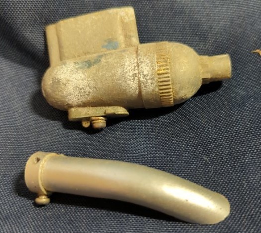

You may be onto something, Levent. The earlier muffler does appear to be of a slightly different aluminum.Levent Suberk wrote:I think that result depends of aluminum type.
7 years ago I did the antifreeze bath, clean-up, then used Mother's Mag and Aluminum Polish on this Enya .35-III TV engine and separately purchased muffler.
https://www.coxengineforum.com/t8180-a-few-tips-i-have-learned-on-restoring-the-19-to-40-red-blue-head-mccoy-engines#104094
Before:
After:
Although it's finish does not mirror an NOS one, it still looked quite acceptable after clean up. It does appear to be cast of a different aluminum alloy.
Perhaps the aluminum is porous enough that Castor and corrosion are easily embedded restricting complete removal, hindering the treatment to chemically bond evenly to the aluminum surface of the older muffler?

Enya muffler update --- important --- please read!
A friend of mine (Rod Wolfe) came over to my house for a little work for me to do for him. (about a week ago.)
While he was there, I showed him the two mufflers hat I had and the problems I had with one of them.
As I talked to my friend (that works in a metallurgy lab) and talked to him about the problem I had with the larger Enya muffler compared to the smaller "new" version.
I told him when I used the Birchwood Casey -- Aluminum Black on the older (Enya M603 60 size) "larger" muffler that the muffler was "smoking" a little as I rubbed on the aluminum black, and it seemed that the muffler getting gritty?
Now on the smaller Enya 19X muffler.
The Aluminum Black darkened the muffler the way it was supposed to with no real problems, unlike the Enya M603 muffler.
Rod looked over the two mufflers that were blackened.
He asked "if" I had any original mufflers that were not blackened?
I asked what for?
He'll take them to work and see what the mufflers composition is.
Rod stopped by my house on his way home from work on Friday (09/12/22)
He told me that the "old" Enya M603 muffler had a mix of 68% aluminum, 23% zinc and 9% magnesium.
The smoking effect was the Birchwood Casey -- Aluminum Black acid reacting with the high amount of zinc in the muffler.
That cause the gritty "stuff" to show up on the muffler and farther pitting the surface.
The newer 19X muffler had only 6% zinc and 19% magnesium. and 75% aluminum.
So, Rod told me the best thing clean the muffler to where it looked almost new is to either sand blast it or wire brush it (gently).
He said I'll never get a supper shiny "chrome" finish in these mufflers because of their composition.
And he advised me "NOT" to use the Birchwood Casey -- Aluminum Black on any of those mufflers!
As the "smoke" coming off the muffler is toxic.
I asked what for?

That is a good accurate assessment by your friend, sosam117. I got fairly close to a mirror finish with Mother's Mag and Aluminum Polish on the old muffler for my .35-III TV, better than the OEM. It is sort of dark, pearl-like. Of course if one wants as manufactured purity in finish, that will never do. But it was certainly an improvement, although not a museum quality (i.e., original) finish.sosam117 wrote:He told me that the "old" Enya M603 muffler had a mix of 68% aluminum, 23% zinc and 9% magnesium. The smoking effect was the Birchwood Casey -- Aluminum Black acid reacting with the high amount of zinc in the muffler. That cause the gritty "stuff" to show up on the muffler and farther pitting the surface.
The newer 19X muffler had only 6% zinc and 19% magnesium. and 75% aluminum. So, Rod told me the best thing clean the muffler to where it looked almost new is to either sand blast it or wire brush it (gently). He said I'll never get a supper shiny "chrome" finish in these mufflers because of their composition.
And he advised me "NOT" to use the Birchwood Casey -- Aluminum Black on any of those mufflers! As the "smoke" coming off the muffler is toxic.

That is a nice-looking muffler (before) compared to some of the mufflers I originally started with.
Going to swap meets, you don't really find those nicer looking mufflers, but you find the ones with this "whitish" stuff on it.
Corrosion and pitting.
That is why I tried the blackening process on those "two" mufflers. (not no more!)
And they can be had for a cheaper price:
This is a muffler that I "was" going to be blackened but I'll give it a good brushing with the steel (fine wire) brush.
And maybe, use a buffing wheel on it?
Wish I had a small bead blasting set-up? That would make it look as good as new?
Ken told me that years ago they use to tumble the parts in a vibrating tumbler with ceramic shaped media.
He sent me a photo of the media. Size is approximately 6mm dia. and a length of 15mm.
