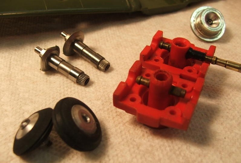

Post  Mark Boesen Sat Dec 20, 2014 12:07 pm
Here's a Mustang built years ago (and of course never flew) Tee Dee cylinder, Black Widow case, flared open backplate 128TPI needle, reworked 1/2a Pylon prop, cut down rubber tires, etc. This ended up in the pile along with the modified PT-19, hot "Mouse" engine (8cc tank) and full travel bellcrank with the thought of outside loops and inverted flight.
