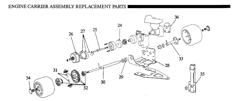

Just received a used motor for my Nissan GTP and after taking the damaged parts off I still need to get the flywheel of so I can replace the front plastic motor mount. I need to know what is the right way to remove the flywheel?? Is there a trick to it?? Right now most of the motor parts are soaking in Alcohol to get them freed up a bit. Can someone help?

The flywheel is probably pressed on like it is on an airplane engine. So lay the back of the crankcase on a hard flat surface, screw a 5-40 stud or screw all the way into the nose of the crankshaft, and whack it with a hammer. I have a brass bar I use as a drift between the hammer and the stud. It should come right out. Use a screw and washers or a propeller to press it back together. It's probably splined, so take care to get it straight back into the grooves.

This is part of the instructions sheets:
The way the flywheel is mounted is different from the Jerobee or the Gassers. The crank end seems to be straight and splined as Rusty suggested. Have a look at this thread. It shows a picture of the crankshaft on p3. It also shows a prop washer but I don't know if this is also mounted (not according to the drawing). It is on the Cox Gassers.
https://www.coxengineforum.com/t2844p50-rc-cars-cox-0-49-cox-stocker-kyosho-f1beetle-killer-bee-backplate-new-video
Maybe Coxaddicted or Happydad can give you a more precise answer or you can send them a pm.
