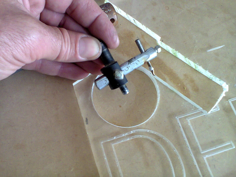

Tee Bee wrote:Thanks for the description. I was also wondering how you went about making the fuel tank. Did you also make the stand from plexi-glass?
Friend, a pleasure to share experiences ... with respect to support, yes, it is an acrylic piece that is used for posters.
The cutting process, I recommend cutting with manual saw, because if an electric saw is used, the speed of the saw causes the acrylic to melt, re-welding between the pieces and generating an unwanted paste.
The hand cut is very good and then you can finish with file and sandpaper, to finally polish (also by hand) with extra fine sandpaper.
The base cut in a circle was made with a cutting tool taken from a mandrel (which I did with an electric machine), then I finished the cutting surface with file and sandpaper, polishing that cut and being very nice.
