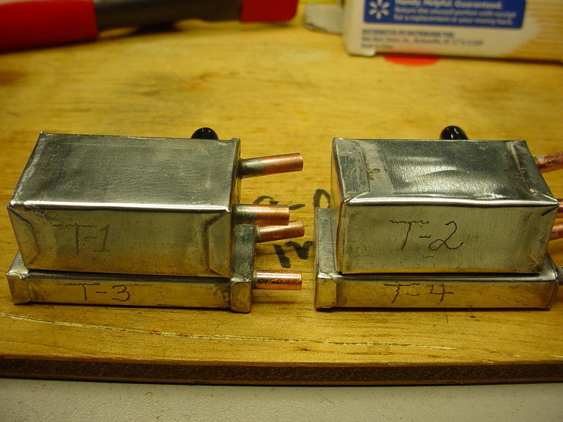

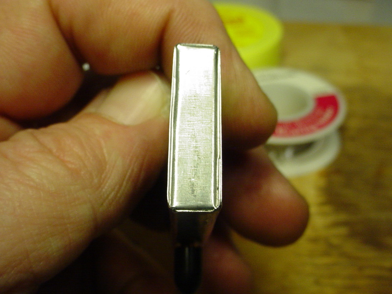

Geez.. I'd forgotten that I'd sent you that tank. I hope it works for you. It's a uni-flow.. so be sure to cap the top tube for operation. It passed a leak-test.. but has not been flight-tested.
Speed Plane Tank Size 1-23-110
Speed Plane Tank Size 1-25-110
Those little tanks were fun to make! Hard-soldering can be very enjoyable.
